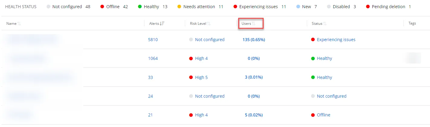

Billable Accounts
Netwrix 1Secure provides an information on the billable accounts – the enabled Active Directory/Microsoft Entra ID (formerly Azure AD) accounts for your organization. You can review these accounts (in numbers and percentage from total numbers of served users) in the Users column on the main dashboard of your Home page.
To view the numbers of the column, your organization should add the Active Directory/Microsoft Entra ID sources and connectors.
You can review the Active Directory/Microsoft Entra ID users on the following dashboards:
  • Managing Organization
tabs
  • Managed Organization
billableaccountsmanagedorg
You can also review the Billable Users reports with the detailed information for each account. See the Billable Users Report topic for additional information.
