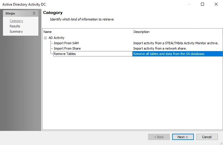

Step 1 – Create a new job and assign a query using the ADActivity Data Collector.
Step 2 – In the Active Directory Activity DC Wizard on the Category page, select the Remove Tables category task.
Step 3 – Click Next to go to the Results page. Optionally, select the Success checkbox to display a confirmation of successful removal in the results after the job is run.
Step 4 – Click Next and then Click Finish to close the Active Directory Activity DC Wizard. Click OK to close the Query Properties window.
When the job is run, all of the ADActivity standard reference tables are removed from the database.
