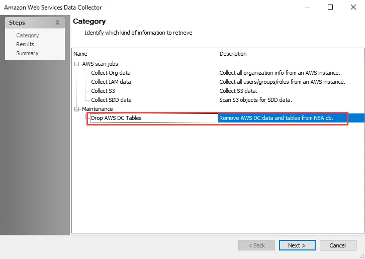

Drop AWS DC Tables option on Amazon Web Services Data Collector Wizard Category page
Step 4 – In the Amazon Web Services Data Collector Wizard on the Category page, select the Drop AWS DC Tables category task. Click Next.
Step 5 – Click Next and then click Finish to close the Amazon Web Services Data Collector Wizard. Click OK to close the Query Properties window.
