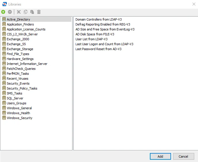

Add Query from Library​
You can add pre-built queries to the Data Collector job through the Libraries window.
Libraries window
The Libraries window toolbar has the following options:
  • Create New Library – Create a new library entry. The new Library appears in the Library dropdown menu.
  • Delete Library – Deletes the selected library
  • Cut – Cut the selected task in the library to the clipboard
  • Copy – Copy the selected task in the library to the clipboard
  • Paste – Paste cut or copied item from the clipboard into the selected library
  • Delete Selected Task – Deletes the selected task
Click Add to confirm the query selection and add it to the Queries list on the Query Selection page. If no selection is needed or intended, click Cancel to close the Libraries window without adding a pre-built query into the Queries list.

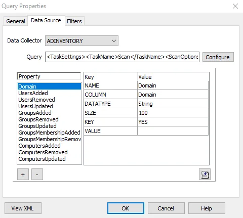

Data Source Tab​
Use the Data Source tab to configure the data collector and query.
Data Source tab of Query Properties for new QueryData Source tab of Query Properties for existing Query
New QueryExisting Query
The Data Source tab displays:
  • Data Collector – Data collector selected from the dropdown menu.
  • Query – Query configuration string.
  • Configure – Opens the wizard for the selected data collector. Each Data Collector task has its own Configuration Wizard.
  • Properties – Configured query properties.
When creating a new query, expand the Data Collector dropdown menu, which provides a list of all licensed data collectors in alphabetical order. The wizard auto-fills the Query and Property sections according to the configuration. The buttons at the bottom of the Property section are for advanced features to manipulate the query. The + and – buttons manually add or remove individual properties from the query. The script button opens the VBScript Editor window for query manipulation scripts.
info
Use the Data Collector Configuration wizards for basic query modifications. For more complex modifications, contact Netwrix Support.
See the individual data collector section for configuration wizard page information.

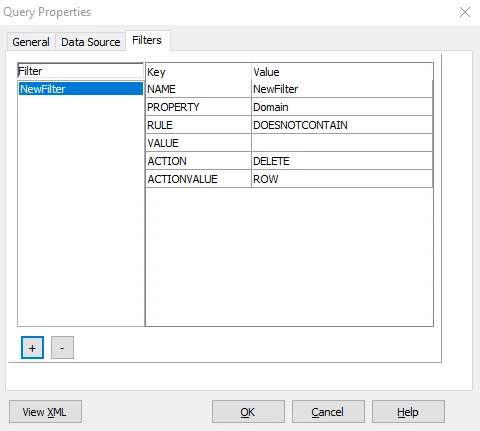

Filters Tab​
Use the Filters tab to include filters into the data collection process.
Filters tab of Query Properties windowFilters tab of Query Properties window with a new filter
No FIlterWith FIlter
The Filter tab has the following items:
  • Filter – Sort through a list of filters that are applied to the current query
    • Use the + and – buttons to add and remove filters from the query
  • Key – Labels identifying the configurable value in the filter
  • Value – When applicable, add a new value to the filter using the dropdown menu. Otherwise, create a new one by typing in the value you want.
info
Use the default settings for filters. Use filters to substitute or delete data values during data collection. For more information on the impacts of adding filters to queries, contact Netwrix Support.
Click OK to save changes and exist the Query Properties window. If you didn't make or intend any changes, click Cancel instead to exit the Query Properties window without saving unintended changes.
