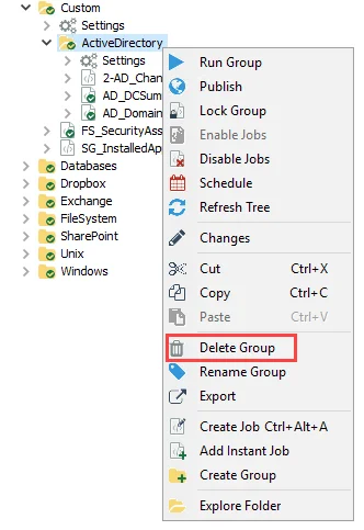

Step 1 – In the Jobs tree, right-click on the job or group that you want to delete and select Delete Job/Group.

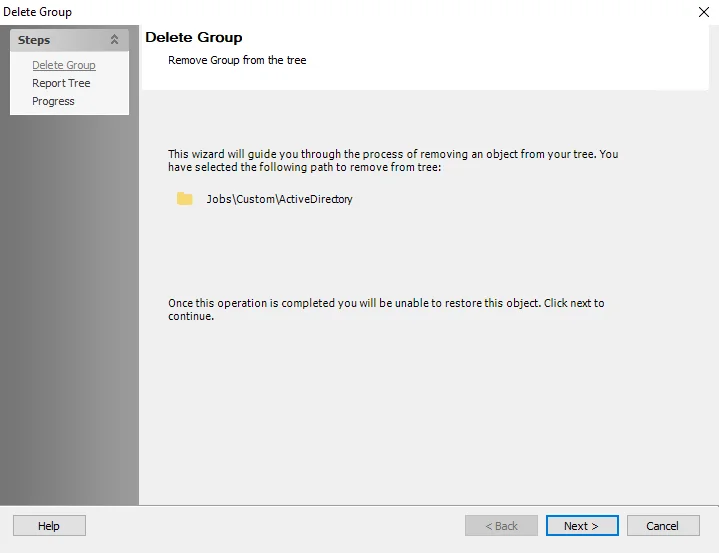

Step 2 – On the Delete Job/Group page of the wizard, confirm it shows the correct job or group that you want to delete, then click Next.
If there are no published reports, clicking Next starts the deletion (skip to step 4).

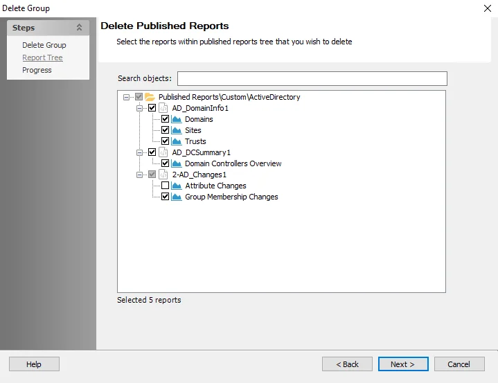

Step 3 – The Delete Published Reports page of the wizard shows the tree of published reports. Select the checkboxes next to all the reports you want to delete. You can also select reports by job group or job. Click Next to proceed with the deletion.
Step 4 – The Progress page shows you the status of the deletion process. When it has completed, click Finish to exit the wizard.

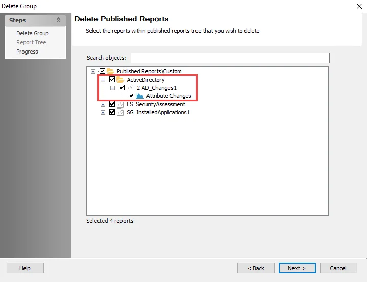

The job or job group and all of the selected published reports have been deleted. If you chose not to delete any of the published reports contained in any of the deleted jobs, then those remaining reports can still be viewed in the Web Console, even though the parent has been removed from the Enterprise Auditor Console.
The remaining published reports that weren't deleted are shown in the wizard if you are deleting the parent group of the previously deleted job or group.
