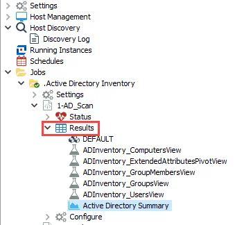

Results Node​
Each job contains a results node where you can view reports generated by that job. Even if the report is unpublished, the report is still displayed here.
Report in the Results node
Select the report you want to view. The report displays in the Results pane of the console.

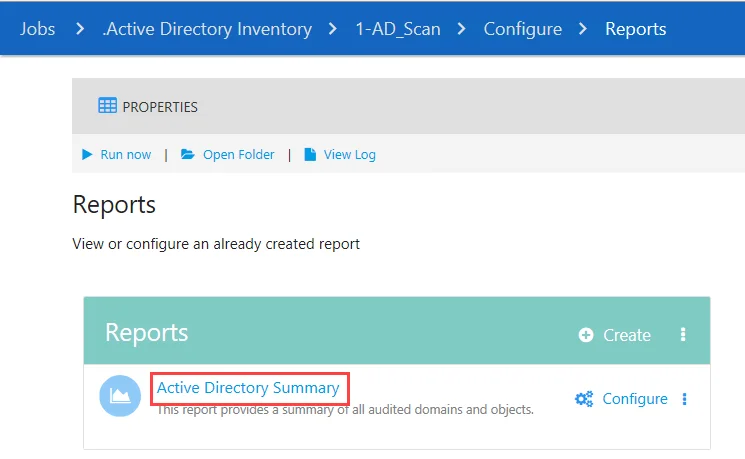

Access report from configure page
You can also access the report from the Configure > Reports page for the job. Click the report title to view the report.

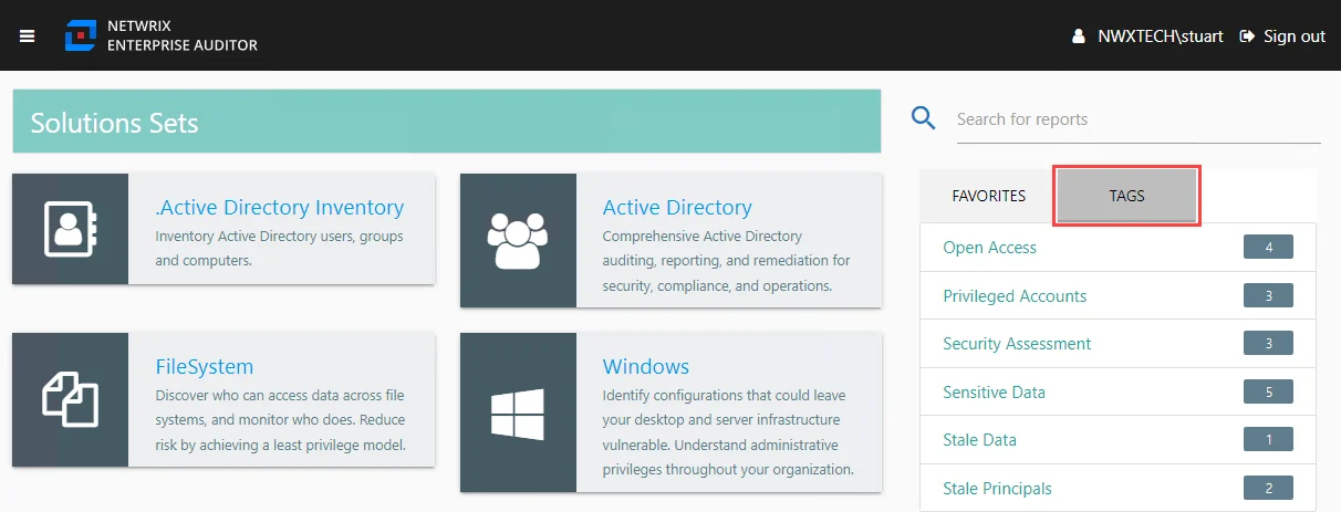

The most common place to view reports is the Web Console. For information on how to access the Web Console, see the Log into the Web Console topic.
Web Console Home page

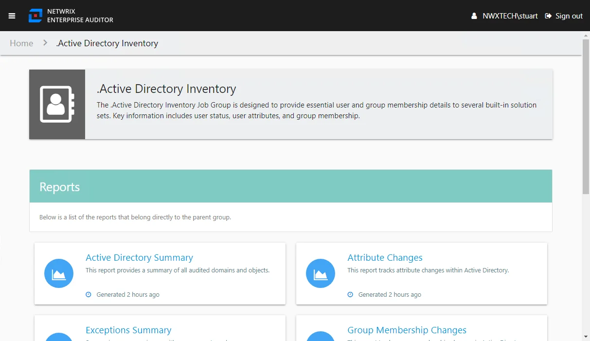

On the home page of the Web Console, select a solution to view a list of all published reports for that solution’s job group. This list includes reports with changed Publish Path locations.
Web Console .Active Directory Inventory
Clicking a report name link opens the selected report, or navigate through the folders to select a report.
