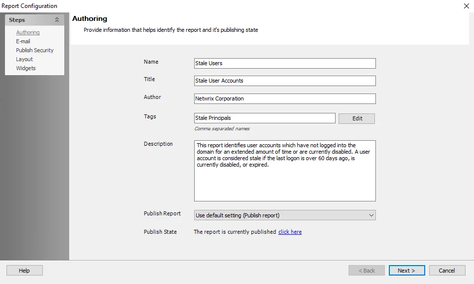

On the Authoring page of the Report Configuration wizard, you can configure the name, header information, and publish settings for the report.
Report Configuration wizard Authoring page
Configure the following settings as required:
name

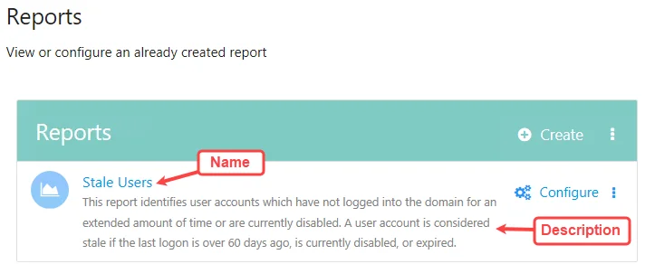

  • Name – The name used for the report in the Enterprise Auditor console and Web Console.
Header Options
header

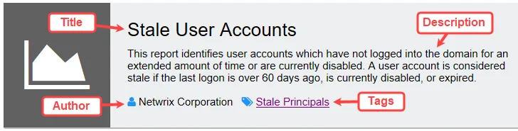

  • Title – The title of the report as displayed at the top of the generated report
  • Author – Name of the person or group who created the report. This is displayed at the top of the generated report.
  • Tags – Use the tag editor to add and remove tags, see the Add Tags to a Report topic for more information. Tags are displayed in the header of the generated reported.
  • Description – A description of the report content. It is displayed beneath the report Title in the generated report.
Publish Options
  • Publish Report – Select an option to configure if the report should be published to the Web Console when it is generated.
    • Use default setting – Applies the Global report settings, or the settings configured at the job group or job levels if inheritance has been broken. (See the Publish Option, Reporting Node, and Report Settings Tab topics for additional information.)
    • Publish report – Select this option to publish the report
    • Don't publish report – Select this option to not publish the report
  • Publish State – Shows the current publish state of the report. If the report is already published, you can click the link to open the report in the Web Console.
