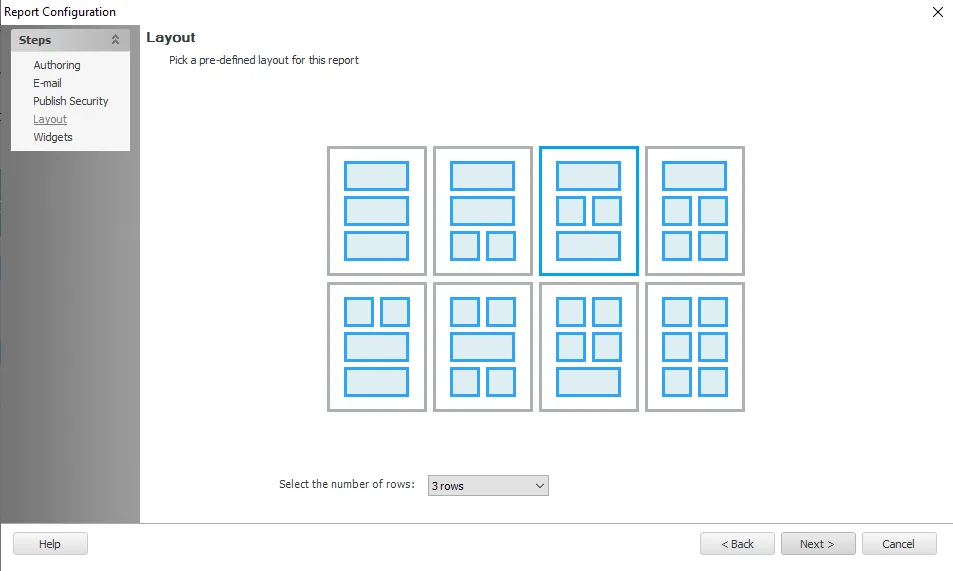

Use the Layout page to configure the layout of the report's content.
layout
To select the layout:
Step 1 – Click the Select the number of rows dropdown menu and select an option from: 1 row, 2 rows, or 3 rows.
Step 2 – Click the layout tile you want for the report.
You've selected the layout for the report. Each box on the selected tile corresponds to a separate widget that you next need to configure on the Widgets Page page of the Report Configuration wizard.
