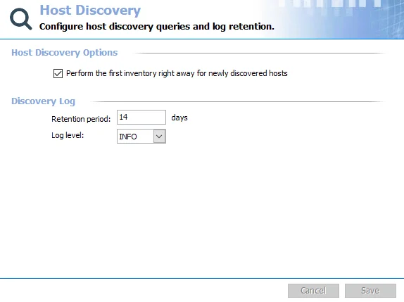

Host Discovery page
In the Host Discovery Options section at the top is a checkbox for the Perform the first inventory right away for newly discovered hosts option. This option is selected by default.
  • If selected, Enterprise Auditor retrieves information about a host as soon as it is discovered
  • If deselected, the host inventory information can be obtained later according to the Host Inventory node options
The configurable options in the Discovery Log section are:
  • Retention period – Determines how long the Host Discovery query log is kept. This is set by default to 14 days which is based on average Enterprise Auditor usage.
  • Log level – Determines what information is stored in the Host Discover query log

The Cancel and Save buttons are in the lower-right corner of the Host Discovery view. These buttons become enabled when modifications are made to the Host Discovery global settings. Whenever changes are made at the global level, click Save and then OK to confirm the changes. Otherwise, click Cancel if no changes were intended.
