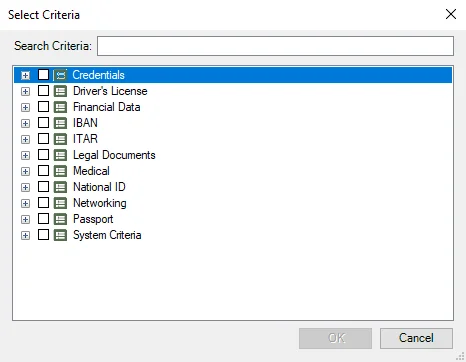

Select Criteria Window​
To add Search Criteria for Sensitive Data scan jobs:
Add criteria
Step 1 – Click Add to open the Select Criteria window.
Step 2 – Select the checkbox to select the criteria. Use the Search Criteria text field to filter the list using keywords or expand each category to view and select individual Sensitive Data search criteria.
Step 3 – Click OK to confirm changes. The Select Criteria window closes.
Step 4 – Click Save on the Sensitive Data view to save changes.
Sensitive Data scan jobs that are set to use global sensitive data criteria settings now inherit the selected Search Criteria.
