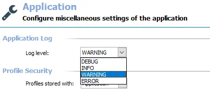

Application Log
The Enterprise Auditor Application Log section determines what information is stored in the Enterprise Auditor application log.
Application Log
The Application log level controls the types of messages generated for each job and the application. It can be modified at the job level in the Job Properties window. See the General Tab topic for additional information. Options available in the Application log level drop-down menu include:
  • Debug – Records everything that happens during job execution, most verbose level of logging
    • Records all Info level information
    • Records everything else that happens
    • Creates the largest file
  • Info – Records information about what stage of the job is being performed when errors or warnings occurred
    • Records all Warning level information
    • Records job progress information
  • Warning – Records all warnings which occur during job execution
    • Records all Error level information
    • Records all warnings and the time of occurrence
  • Error – Records all errors which occur during job execution
    • Records job start time
    • Records errors and the time of occurrence
    • Records job completion time
RECOMMENDED: Set the log level to Warning.
The other log levels are designed to assist with troubleshooting job execution issues. The Debug level is only recommended when experiencing problems. After the problem is fixed or the Application log has been sent to Netwrix Support, reduce the logging level to Warning or Info.
