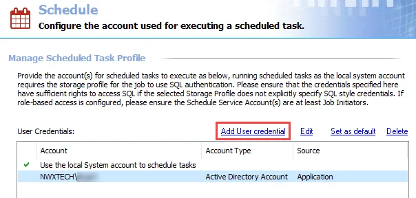

Add User credential option in the Schedule view
Step 1 – Click Add User credential at the top of the Schedule view. The User Credentials window opens.

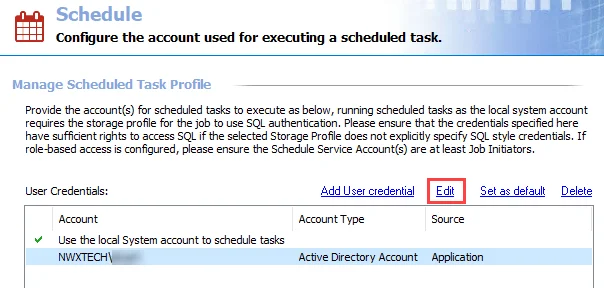

Edit option in the Schedule view
Step 1 – Select a credential from the User Credentials list and click on Edit. The User Credentials window opens.

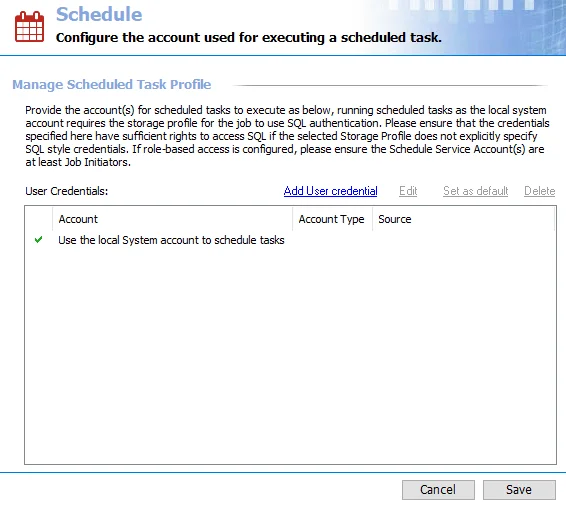

Step 3 – The User Credentials list now reflects the absence of the deleted Schedule Service Account. Click Save and then OK to confirm the changes. To ensure these changes take effect, exit and restart the Enterprise Auditor application.
If all Schedule Service Accounts are removed and only the local System account remains, Enterprise Auditor cannot create or run scheduled tasks unless the local system account has adequate permissions.
