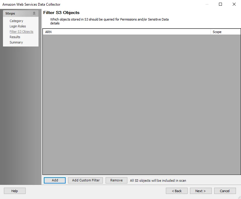

AWS: Filter S3 Objects
The Filter S3 Objects page provides the options to filter which objects stored in S3 should be queried for permissions and sensitive data. It is a wizard page for the categories of:
  • Collect S3
  • Collect SDD Data
Use the buttons to customize the filter list:
  • Add – Opens the Select a bucket window. See the Add Filter topic for additional information.
  • Add Custom Filter – Create a custom filter. See the Add Custom Filter topic for additional information.
  • Remove – Remove a filter from the list
Add Filter
The Select a Bucket window shows the available buckets in the AWS instance.
Select from the available buckets and click OK to add them to the Filter S3 Objects page.
Add Custom Filter
The Add Custom Filter window allows a custom filter to be configured.
Configure a custom filter using the following format:
  • The characters * and ? are wildcards
    • * – matches any number of characters
    • ? – matches a single character
  • ARN should follow the format: arn:aws:s3:::<bucket_name>/<key_name>
Click Save to add the custom filter to the Filter S3 Objects page.

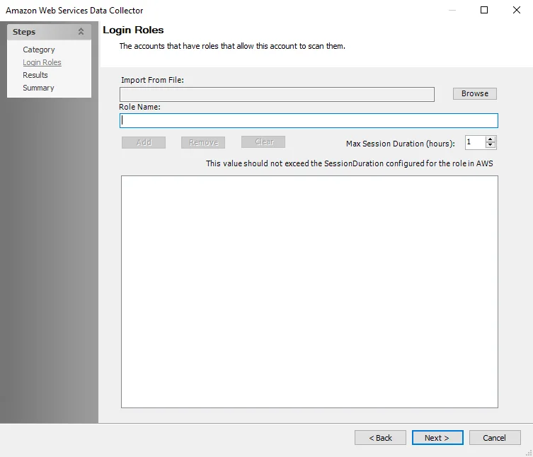

AWS: Login Roles
The Login Roles page is where the previously created AWS Roles are added. It is a wizard page for the categories of:
  • Collect Org data
  • Collect IAM data
  • Collect S3
AWS Query Login Roles
Add the login roles that will allow Enterprise Auditor to scan the AWS accounts. See the Configure AWS for Scans topic for additional information. The page has the following options:
  • Import From File – Browse to the location of a CSV file from which to import the roles
  • Role Name – Enter the name of the role
  • Add – Add the role from the Role Name textbox to the list
  • Remove – Remove the selected role from the list
  • Clear – Remove all roles from the list
  • Max Session Duration (hours) – Specify the maximum time the account can be logged in for. This value should not exceed the SessionDuration configured for the role in AWS. The default value is 1 and the maximum value is 12.
