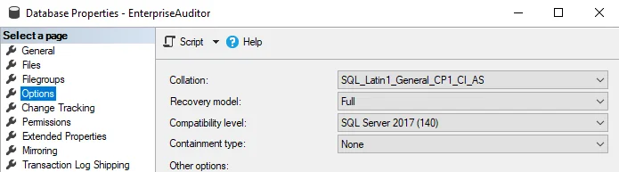

Change Collation at the Database Level
Follow the steps to change the collation at the database level.
Step 1 – Access the Database Properties in SQL Server Management Studio.
Step 2 – Select Options and set the collation.
Now that the collations match, proceed with Enterprise Auditor installation.

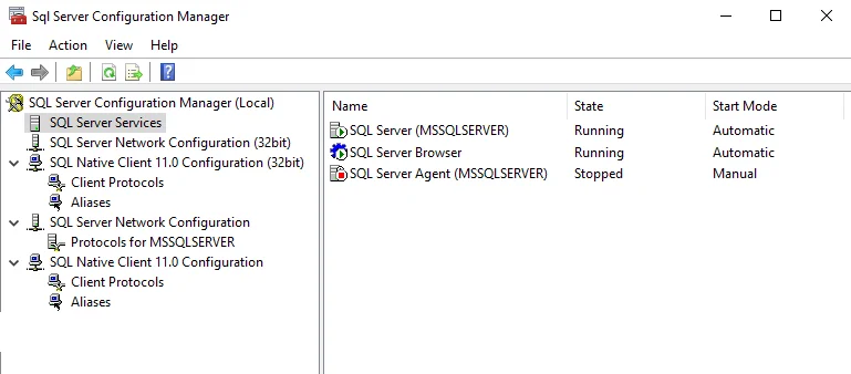

Change Collation at the SQL Server Level
Follow the steps to change the collation at the SQL Server level.
Step 1 – Stop the SQL Server service from the Configuration Manager.
