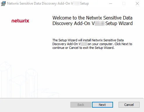

Step 2 – On the Welcome page, click Next to begin the installation.

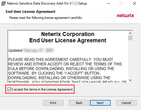

Step 3 – Check the I accept the terms in the License Agreement box and click Next.

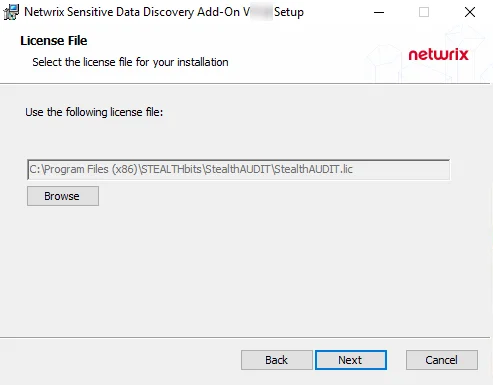

Step 4 – Click Browse to select the license file to use for installation. By default, this will target the license key within the Enterprise Auditor installation directory. If installing on the SharePoint Agent server or the File System Proxy server, use the Browse button to navigate to the license file. Click Next.
The Enterprise Auditor license file needs to be locally accessible during the installation process.

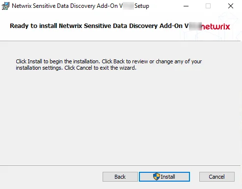

Step 5 – Click Install to begin the installation.
Step 6 – When the installation has completed, click Finish to exit the wizard.
