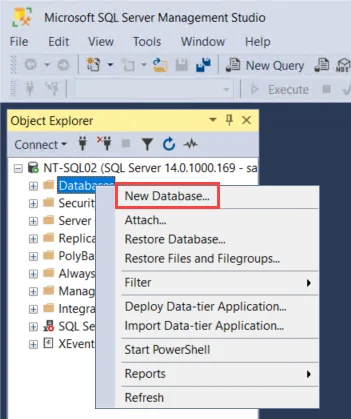

Step 1 – Create a new database for use with Enterprise Auditor. Right-click on the Databases node and choose New Database.

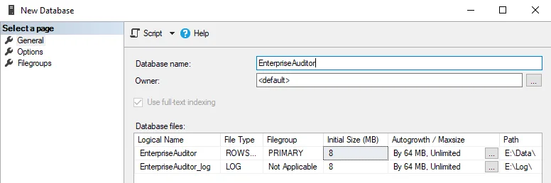

Step 2 – Set the Database name. Set any other desired data files configuration per company standards. Click OK on the New Database window.
RECOMMENDED: Enter Enterprise Auditor as the Database name.

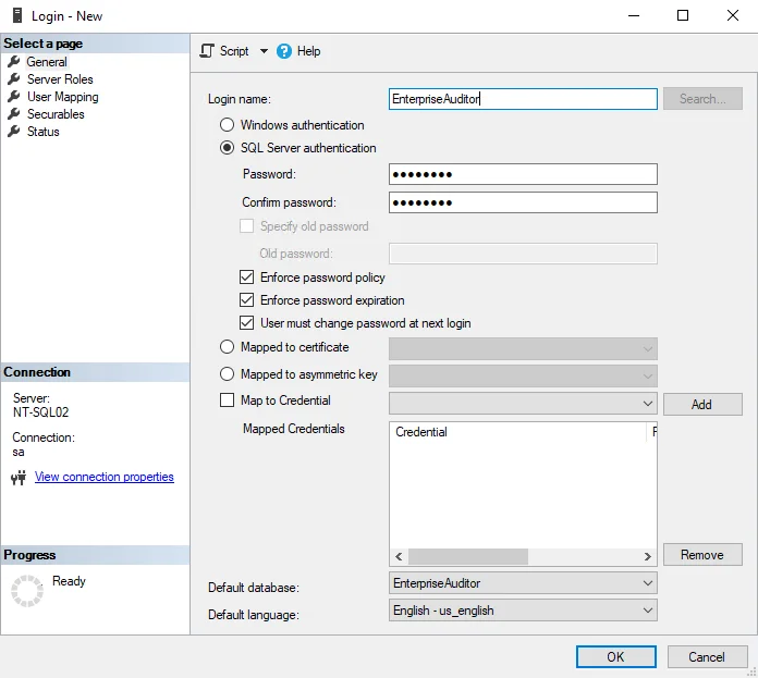

Step 3 – Create a new SQL Login account by right-clicking on the Security > Logins folder and selecting New Login.
Step 4 – Choose the authentication mode as the login type for use with the newly created Enterprise Auditor database. The available options are Windows authentication and SQL Server authentication.
SQL Server Management Studio new login with Windows authentication

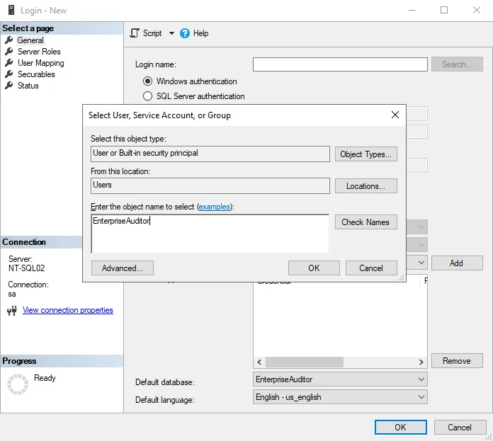

  • If Windows authentication is desired, then click Search and select the desired Windows account, which has been set up for use with Enterprise Auditor.
SQL Server Management Studio new login with SQL Server authentication
  • RECOMMENDED: If SQL Server authentication is desired, use a login name called Enterprise Auditor.
NOTE: Set the Default Database as Enterprise Auditor (or the desired Enterprise Auditor database) and choose English as the Default Language.

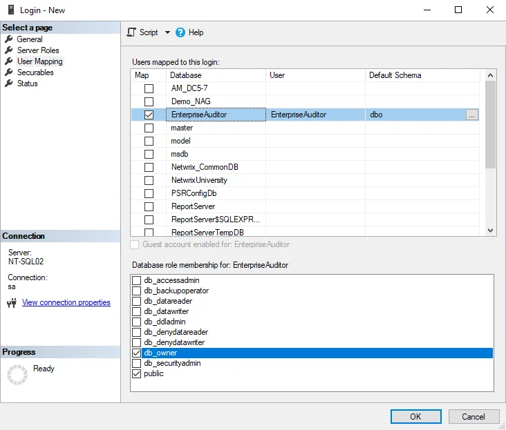

SQL Server Management Studio New Login User Mapping
Step 5 – Navigate to the User Mapping menu, select the Enterprise Auditor (or the desired Enterprise Auditor database) database, and set the Default Schema to DBO.
Step 6 – In the Database role membership section, set the role to db_owner. Click OK to save new user configuration information and continue on to configure the Enterprise Auditor Console.

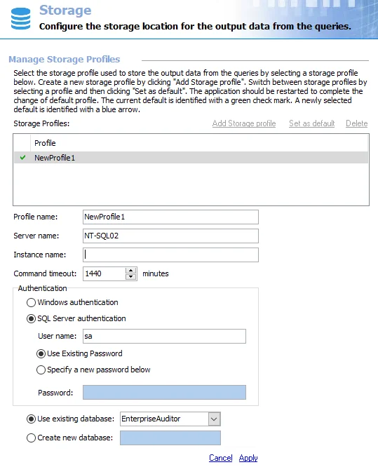

Step 8 – Launch Enterprise Auditor and navigate to Settings > Storage.
  • Select the Storage Profile and enter the name of the SQL Server in the Server name field and Instance Name, if applicable.
  • Enter the name of the Enterprise Auditor database in the Use existing database field.
  • Choose the authentication method which matches the secure login that was created in Step 4, either Windows authentication or SQL Server authentication. If using SQL Server authentication, enter the User name and Password.
Connection report window
  • Click Apply and a Connection report window will open. Verify that the connection and test table drop were performed successfully.
  • Click Close on the Connection report window and then Save the new Storage Profile.
