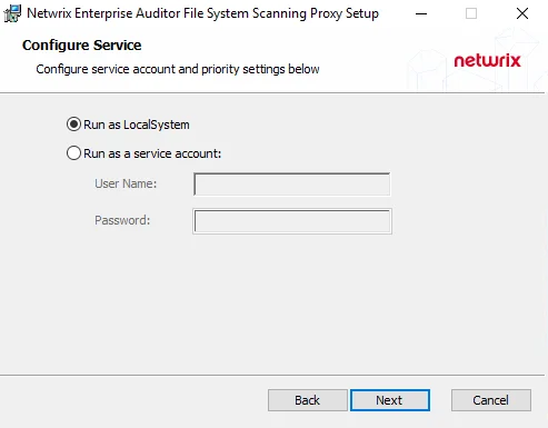

SharePoint Agent Setup Wizard Configure Service Security page
Step 5 – On the Configure Service Security page, enter the User Name and Password for the SharePoint Service Account. Click Next.
