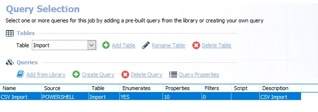

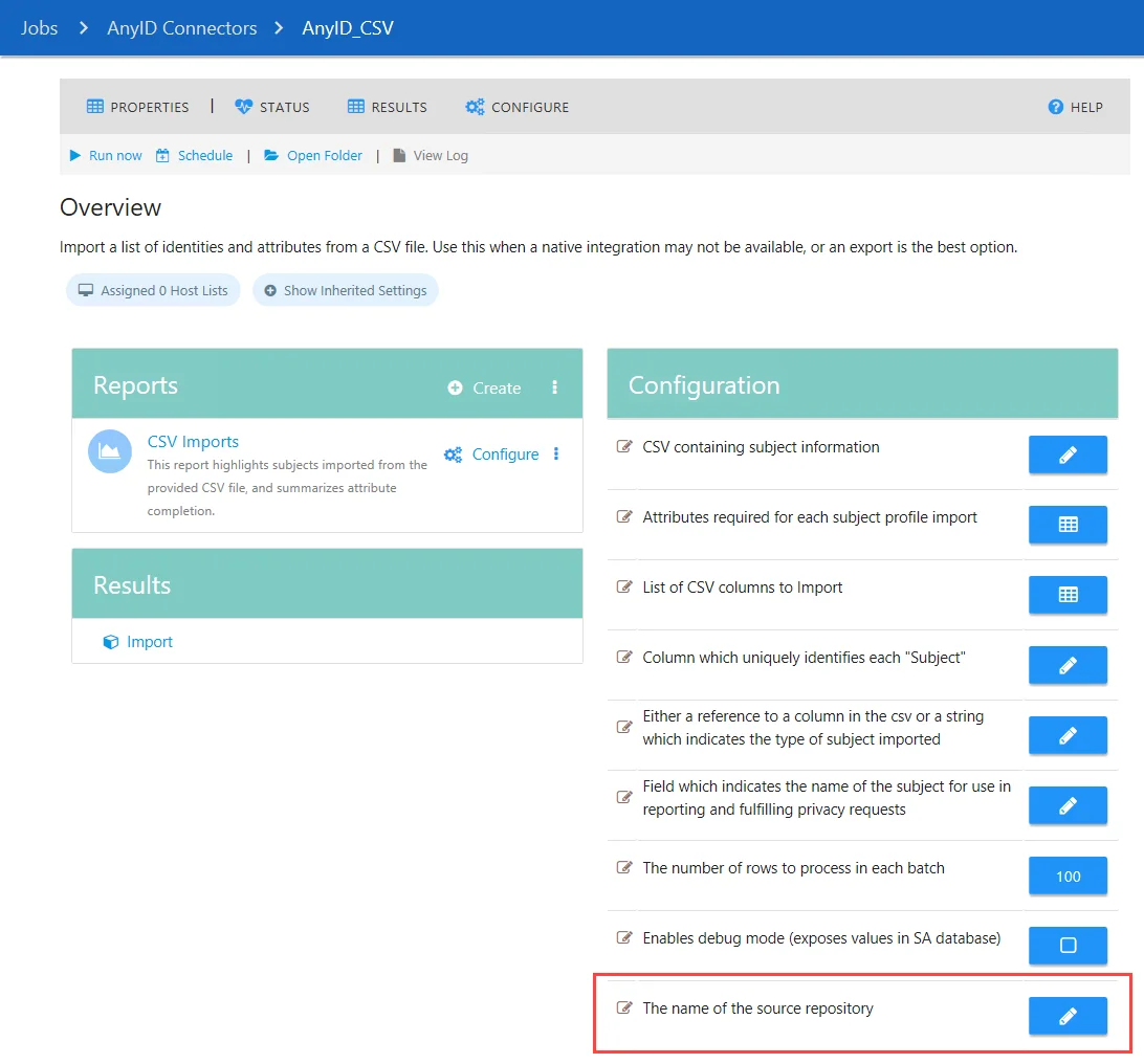

Step 1 – Navigate to and select the AnyID Connectors > AnyID_CSV node. In the Configuration section of the job's Overview page, click the configure button for the The name of the source repository parameter. In the Configure Window, enter the name of the source repository where the list of identities and related attributes were retrieved from.
Step 2 – Navigate to the AnyID Connectors > AnyID_CSV > Configure node and select Queries.
Step 3 – In the Query Selection view, select the CSV Import query and click Query Properties. The Query Properties window opens.

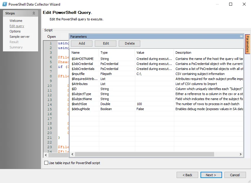

Step 4 – Select the Data Source tab, and click Configure. The PowerShell Data Collector Wizard opens.
Step 5 – Navigate to the Edit Query page. Click the Parameters tab on the right-hand side of the page to expand the Parameters window. Configure the following attributes:
CAUTION: The following attributes must be configured in order for the job to execute properly.
$inputfile – File path to the CSV file which contains the identity and attribute information
$RequiredAttributes – The list of attributes that need to be found in the document in order to trigger a match
- An attribute in the Attributes list will not be considered a match (in reporting and AIC) unless an attribute in the RequiredAttributes list is also found in the same file
$Attributes – The list of attributes that will be scanned for during sensitive data scanning
$ID – Column which uniquely identifies each subject
$SubjectType – Either a reference to a column in the CSV file or a string which indicates the type of subjects being imported
$batchSize – (Optional) The number of rows to process in a batch. Leave at default unless otherwise required.
$debugMode – (Optional) When set to true, stores unhashed attribute values for troubleshooting purposes
Step 6 – Click Next. Continue to the Sample server page and click Finish to save changes. Click Cancel to exit the wizard without saving changes.

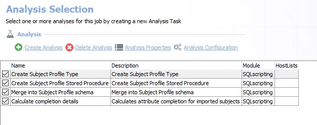

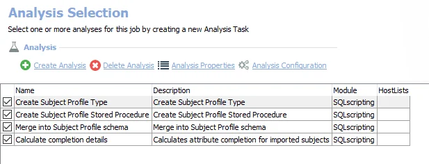

Analysis Tasks for the AnyID_CSV Job
Navigate to the Jobs > AnyID Connectors > AnyID_CSV > Configure node and select Analysis to view the analysis tasks.
- Create Subject Profile Type – Creates subject profile type
- Create Subject Profile Stored Procedure – Creates subject profile stored procedure
- Merge into Subject Profile schema – Merges into subject profile schema
- Calculate completion details – Calculates attribute completion for imported subjects

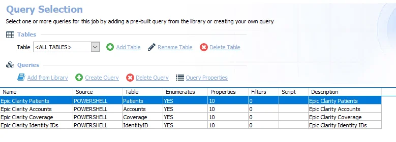

Queries for the AnyID_EpicClarity Job
The AnyID_EpicClarity job uses the PowerShell Data Collector for queries.
The queries are:
- Epic Clarity Patients – Imports Epic Clarity subject profile information for patients
- Epic Clarity Accounts – Imports Epic Clarity subject profile information on accounts
- Epic Clarity Coverage – Imports Epic Clarity subject profile information on coverage
- Epic Clarity Identity IDs – Imports Epic Clarity subject profile information on identity IDs
The above queries have configurable parameters. See the Configure the AnyID_EpicClarity Queries topic for additional information.

Step 1 – Navigate to the AnyID Connectors > AnyID_EpicClarity > Configure node and select Queries.
Step 2 – In the Query Selection view, select a query and click Query Properties. The Query Properties window opens.

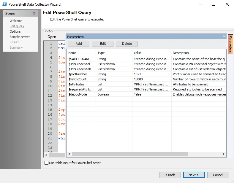

Step 3 – Select the Data Source tab, and click Configure. The PowerShell Data Collector Wizard opens.
Step 4 – Navigate to the Edit Query page. Click the Parameters tab on the right-hand side of the page to expand the Parameters window. See the PowerShell: Edit Query topic for additional information. Configure the following attributes as needed:
$portNumber – The port number used to access the Oracle Database Server
$fetchCount – The number of rows to process in a batch. Leave at default unless otherwise required.
$Attributes – The list of attributes that will be scanned for during sensitive data scanning. Default values are MRN, SSN, Name, Date of Birth, Subscriber ID, Identity ID, and Account ID.
$RequiredAttributes – The list of attributes that need to be found in the document in order to trigger a match. The default values are SSN, MRN, and IdentityID.
$debugMode – When set to true, stores unhashed attribute values for troubleshooting purposes
Step 5 – Click Next. Continue to the Sample server page and click Finish to save changes. Click Cancel to exit the wizard without saving changes.

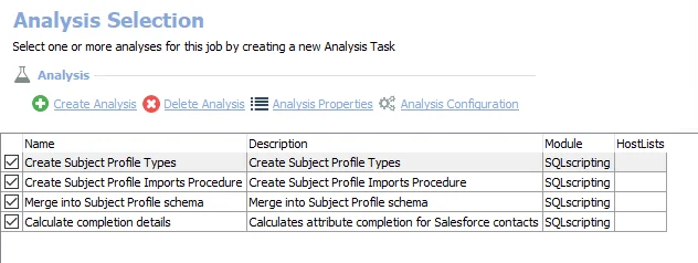

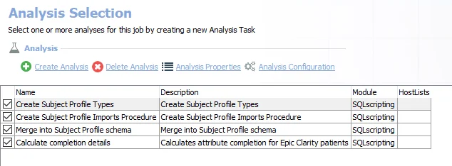

Analysis Tasks for the AnyID_EpicClarity Job
Navigate to the Jobs > AnyID Connectors > AnyID_EpicClarity > Configure node and select Analysis to view the analysis tasks.
- Create Subject Profile Types – Create subject profile types
- Create Subject Profile Imports Procedure – Create subject profile imports procedure
- Merge into Subject Profile schema – Merge into Subject Profile schema
- Calculate completion details – Calculates attribute completion for Epic Clarity patients

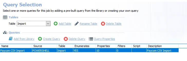

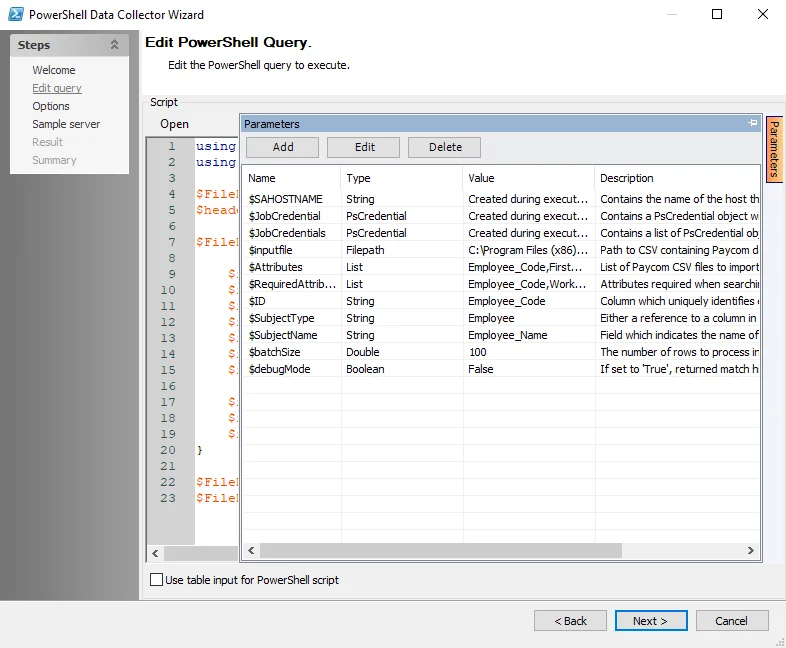

Step 1 – Navigate to the AnyID Connectors > AnyID_Paycom > Configure node and select Queries.
Step 2 – In the Query Selection view, select the Paycom CSV Import query and click Query Properties. The Query Properties window opens.
$SAHOSTNAME – Created during execution. This parameter cannot be modified.
$JobCredential – Created during execution. This parameter cannot be modified.
$JobCredentials – Created during execution. This parameter cannot be modified.
$SubjectType – Either a reference to a column in the csv file or a string which indicates the type of subjects being imported
$SubjectName – Either a reference to a column in the csv file or a string which indicates the name of the subjects being imported
$batchSize – The number of rows to process in a batch. Leave at default unless otherwise required.

Step 1 – Navigate to the AnyID Connectors > AnyID_Salesforce > Configure node and select Queries.
Step 2 – In the Query Selection view, select the PS Salesforce Import query and click Query Properties. The Query Properties window opens.
$SubjectType – A string which indicates the type of subjects being imported
$SubjectName – A string which indicates the name of the subjects being imported

Analysis Tasks for the AnyID_Salesforce Job
Navigate to the Jobs > AnyID Connectors > AnyID_Salesforce > Configure node and select Analysis to view the analysis tasks.
- Create Subject Profile Types – Creates subject profile types
- Create Subject Profile Imports Procedure – Creates subject profile imports procedure
- Calculate completion details – Calculates attribute completion for Salesforce contacts
