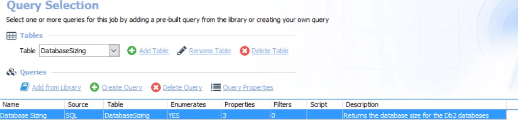

Queries for the 3-Db2_Configuration Job
The 3-Db2_Configuration Job uses the SQL Data Collector for queries.
The query is:
- Database Sizing — Returns the database size for the Db2 databases
