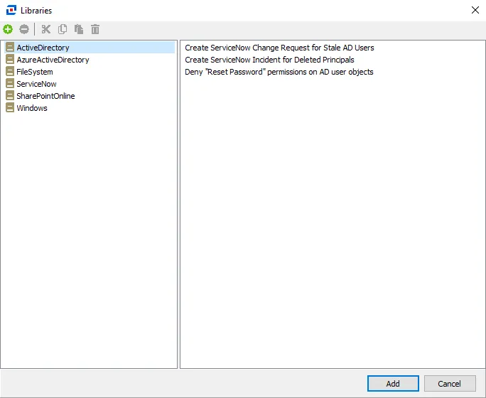

On the job's Configure > Action node, the Add from Library option opens the Libraries window with the available Action Libraries and operations:
When a specific operation within a library is chosen, the action is added in the disabled state to the job. The Action Properties page opens, which has a description, action module, and source table with relevant filters applied.

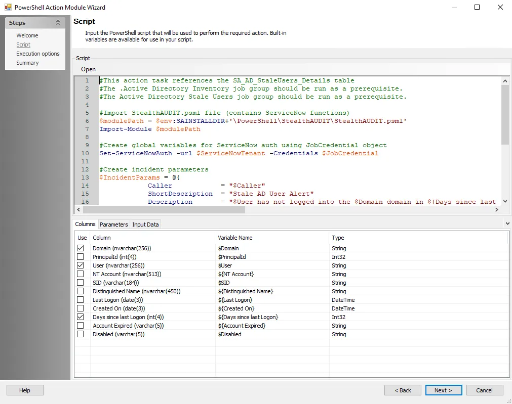

When you click the Configure Action link, the action module's wizard opens.
The following Action Libraries and Templates leverage the PowerShell Action module for running actions within the specific environment:

Prerequisite information for each of the PowerShell scripts is included as part of the script comments. Typically, a script requires necessary cmdlets available and installed, as well as parameter inputs configured.

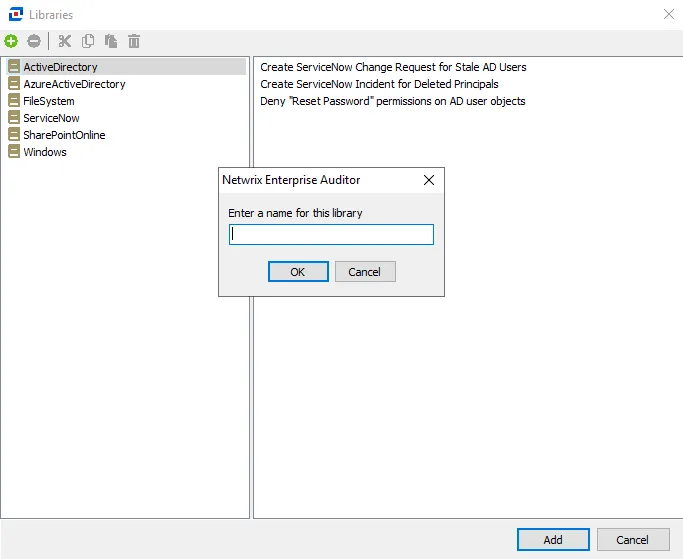

Step 2 – Click the Add from Library link to open the Libraries window.
Step 3 – Click the green plus sign on the top left to add a new library.
Step 4 – In the pop-up window, specify a name for the library and click OK.
Step 5 – Select the new library and paste the copied action task.
