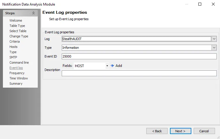

The Event Log properties page is available when the Event log notification type is selected on the Type page. Use this page to specify the type of event, the event ID, and the description for the event.
The following options are available:
Log – The event log name is Access Analyzer
Type – Specify the log type. The drop-down menu displays the following options:
- Information
- Warning
- Error
- FailureAudit
- SuccessAudit
Event ID – Specify the event ID
Description – Enter a description of the event
- Fields – To pass fields into the description, click on the drop-down list, select a field from the list, then click Add
