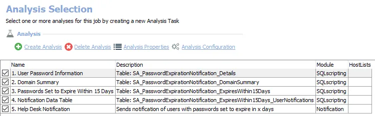

Analysis Tasks for the AD_PasswordExpirationNotification Job
Navigate to the Jobs > AD_PasswordExpirationNotification > Configure node and select Analysis to view the analysis tasks.
- 1. User Password Information – Creates the PasswordExpirationNotification_Details table
accessible under the job’s Results node
- Contains a configurable parameter for the number of days until a password expires to be identified
- See the Customizable Analysis Tasks for the AD_PasswordExpirationNotification Job topic for additional information.
- 2. Domain Summary – Creates an interim processing table in the database for use by downstream analysis and report generation
- 3. Passwords Set to Expire Within 15 Days – Creates the PasswordExpirationNotification_ExpiresWithin15Days table accessible under the job’s Results node
- 4. Notification Data Table – Creates the PasswordExpirationNotification_ExpiresWithin15Days_UserNotifications table accessible under the job’s Results node
- 5. Help Desk Notification – Sends notification of users with passwords set to expire in X days
- See the Notification Analysis Task in the AD_PasswordExpirationNotification Job topic for additional information.

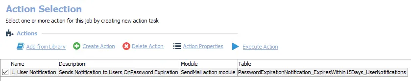

Action for the AD_PasswordExpirationNotification Job
Navigate to the Jobs > AD_PasswordExpirationNotification > Configure node and select Actions to view the action modules.
This action is enabled by default.
The default actions are:
- 1. User Notification – Uses the SendMail Action Module to send notifications to users on
password expiration
- Requires the Notification Actions license feature
- See the Action Task in the AD_PasswordExpirationNotification Job topic for additional information.

Step 1 – Navigate to the AD_PasswordExpirationNotification > Configure node and select Analysis to view the analysis tasks.
Step 2 – In the Analysis Selection view, select the 1. User Password Information Analysis Task and click on Analysis Configuration. The SQL Script Editor opens.

Step 1 – Navigate to the AD_PasswordExpirationNotification > Configure node and select Actions.
Step 2 – In the Action Selection view, select the 1. User Notification Action Task and click on Action Properties to view the actions.
