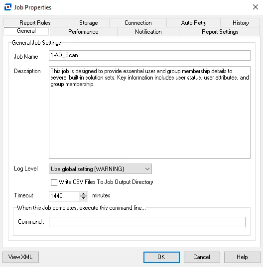

General Tab
The General tab is for changing the job name and description.
General tab of Job Properties
The following options are available:
  • Job Name
  • Description
  • Log Level – Indicates the job log level, which can be inherited from the global Settings > Application log level or customized here. See the Log Level topic for additional information.
  • Write CSV Files To Job Output Directory – Exports the native data table created by a query to a CSV file in the job’s output directory. If there are multiple tables in the job, this option creates one file per table.
  • Timeout [value] minutes – Job’s thread timeout value
  • Command – lets you enter a command that will be executed from the command line upon job completion

Log Level Options
For example, this is where you set the messaging for Info, Warning, or Error at a job level.
