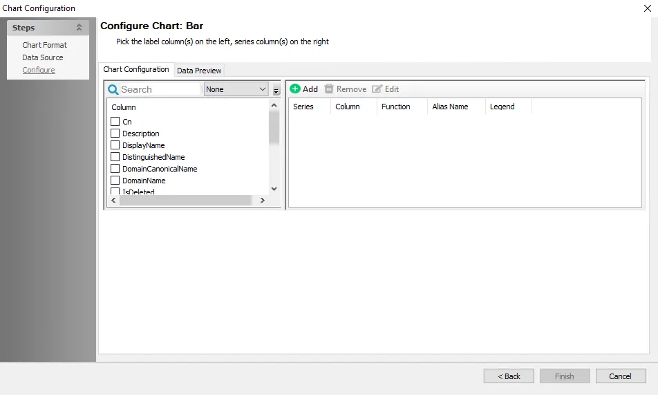

Chart Configuration​
The Chart Configuration tab is split into three sections, label column selection, series configuration, and a chart preview. Use this tab to configure the columns from the data source to be shown in the chart.
Chart Configuration wizard Configure page
The left side shows all the columns from the data source table that you can use for the label axis. For example, the label column is the x-axis on a line chart and the y-axis on a bar chart. Select the checkbox of the label column you want from the list. You can use the search bar to filter this list of columns.
If a datetime label column has been selected, you can optionally select a transformation function using the dropdown menu. Transformation functions group the column data by the selected function and the function is then used as the label. The possible transformation functions are Day, Month, or Year.
The table on the right is where the data series are configured. For configured data series, the table displays the series type (XAxis, YAxis, or DataValue), column name, aggregation function, friendly alias name, and legend color. Use the buttons above the table to add new or configure existing data series. The following options are available:
  • Add – Opens the Add new series window to configure a new data series. See the Add New Series / Edit Series Window topic for additional information.
  • Remove – Removes the selected data series from the chart
  • Edit – Opens the Edit series window for the selected series. See the Add New Series / Edit Series Window topic for additional information.
  • Color Picker – Available only for pie charts. Opens the Pie slices color window, which allows you to customize the color for each slice of the pie chart. On the Pie slices color window:
    • Select the row of the value you want to customize and click Change Color
    • Use the color picker to choose the color you want, then click OK
    • Repeat for each color you want to customize
    • Click OK to save your selections and close the Pie slices color window, or click Cancel to close the window without changing the colors
At the bottom of the page is a preview of the chart as it is configured using the available data. See the Chart Preview topic for additional information. Additionally, you can see a preview of the source data table in the Data Preview tab. See the Data Preview topic for additional information.
After you finish configuring the chart, click Finish to close the wizard. You are returned to the Widgets page of the Report Configuration wizard, where the newly configured chart is shown. You must complete the Report Configuration wizard to save the chart on the report. See the Widgets Page topic for additional information.
