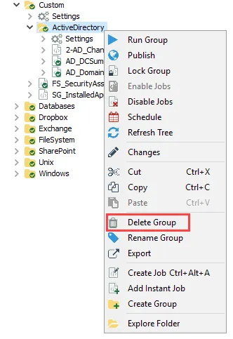

Delete Group on right-click menu
Step 1 – In the Jobs tree, right-click on the job or group that you want to delete and select Delete Job/Group.
