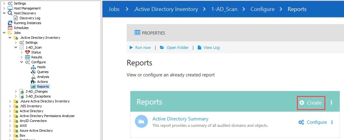

You can create a new custom report for an existing job from the job’s Reports node.
Step 1 – Navigate to Jobs > [Job] > Configure and select the Reports node.
Create report option
Step 2 – On the Reports page, click Create.
Step 3 – The Report Configuration wizard is automatically launched. Use the wizard to configure the new report as required, see the Report Configuration Wizard topic for instructions. Click Finish on the final page of the wizard to create the report.
The new report is added to the Reports table.
