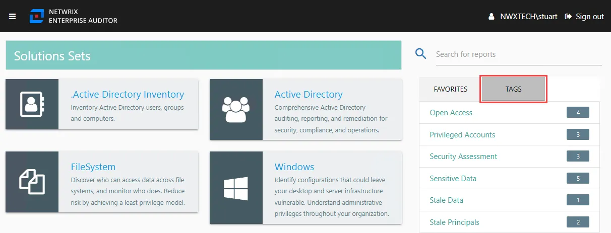

Web Console​
The most common place to view reports is the Web Console. For information on how to access the Web Console, see the Log into the Web Console topic.
Web Console Home page
On the home page of the Web Console, select a solution to view a list of all published reports for that solution’s job group. This list includes reports with changed Publish Path locations.
Web Console .Active Directory Inventory
Clicking a report name link opens the selected report, or navigate through the folders to select a report.
