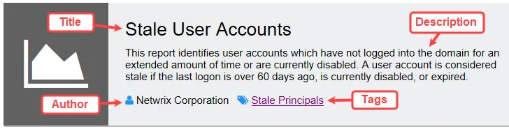

  • Title – The title of the report as displayed at the top of the generated report
  • Author – Name of the person or group who created the report. This is displayed at the top of the generated report.
  • Tags – Use the tag editor to add and remove tags, see the Add Tags to a Report topic for more information. Tags are displayed in the header of the generated reported.
  • Description – A description of the report content. It is displayed beneath the report Title in the generated report.
