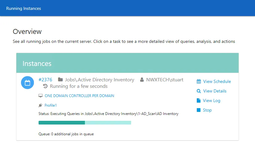

Overview​
The Overview page displays information about all running jobs on the current server.
Overview page
For each instance this screen provides :
  • Job path
  • Credential used
  • Running time of the job
  • Status of the running job
  • Number of jobs scheduled in queue
It also has hyperlinks for:
  • Process ID
  • Host Name
  • Connection Profile
  • View Details
  • View Log
  • Stop
  • View Schedule
Clicking on any of the hyperlinks displays more information about the running job. The ProcessID, View Details, View Log, and Stop links only work while the job is running. After the job is complete, these links are disabled. The host and Connection Profile links continue to work. The View Schedule link only displays and is valid for jobs that are running via a scheduled task and isn't enabled for interactive job executions.
