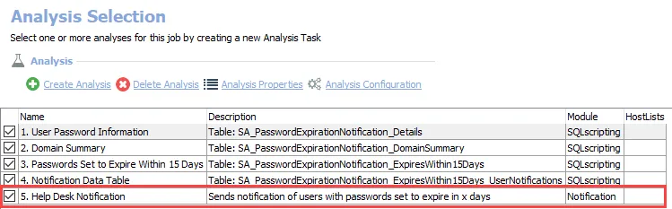

Analysis Tasks for the AD_PasswordExpirationNotification Job
Navigate to the Jobs > AD_PasswordExpirationNotification > Configure node and select Analysis to view the analysis tasks.
- User Password Information – Creates the PasswordExpirationNotification_Details table accessible under the job’s Results node
- Contains a configurable parameter for the number of days until a password expires to be identified
- See the Customizable Analysis Tasks for the AD_PasswordExpirationNotification Job topic for additional information.
- Domain Summary – Creates an interim processing table in the database for use by downstream analysis and report generation
- Passwords Set to Expire Within 15 Days – Creates the PasswordExpirationNotification_ExpiresWithin15Days table accessible under the job’s Results node
- Notification Data Table – Creates the PasswordExpirationNotification_ExpiresWithin15Days_UserNotifications table accessible under the job’s Results node
- Help Desk Notification – Sends notification of users with passwords set to expire in X days
- See the Notification Analysis Task in the AD_PasswordExpirationNotification Job topic for additional information.

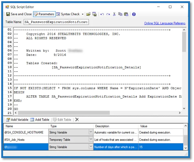

Customizable parameters enable Access Analyzer users to set the values used to classify user and group objects during this job’s analysis. The parameters can be customized and are listed in a section at the bottom of the SQL Script Editor. Follow the steps to customize an analysis task’s parameters.
CAUTION: Do not change the table names or report name to align with a different value supplied for this parameter. Modifying the table names will result in analysis and report errors downstream. Only the report title and descriptions can be modified within the report configuration.
Analysis Task | Customizable Parameter Name | Default Value | Value Indicates |
1. User Password Information | @pswLen | 15 | Number of days left until a password expires, should be set according to an organizations policy. |
The parameters that can be customized are listed in a section at the bottom of the SQL Script Editor. Follow the steps to customize an analysis task’s parameters.
Step 1 – Navigate to the AD_PasswordExpirationNotification > Configure node and select Analysis to view the analysis tasks.
Step 2 – In the Analysis Selection view, select the 1. User Password Information Analysis Task and click on Analysis Configuration. The SQL Script Editor opens.
Step 3 – In the parameters section at the bottom of the editor, find the Value column. Double-click on the current value and change as desired.
CAUTION: Do not change any parameters where the Value states Created during execution.
Step 4 – Click Save and Close to finalize the customization and close the SQL Script Editor.
The new value will be applied to the next job execution.

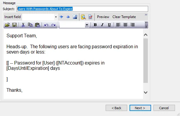

The Notification Analysis Task can be used to send a single email to specified recipients containing a list of all users whose passwords will expire in the specified number of days, that is the users listed in the PasswordExpirationNotification_ExpiresWithin15Days table. The analysis is enabled by default. Therefore, when the job is executed the following message is sent to the specified recipient, such as the organization’s help desk, with information from the associated table:
Subject: Users with Passwords About To Expire
Support Team,
Heads-up. The following users are facing password expiration in seven days or less:
[[ -- Password for [User] ([NTAccount]) expires in [DaysUntilExpiration] days
Thank you,
Netwrix
CAUTION: Do not modify the tags, highlighted in bold text above.
The Subject or message body can be modified, for example to replace Netwrix
with the
organization’s name. Follow the steps to configure the 5. Help Desk Notification Analysis Task.
Step 1 – Navigate to the AD_PasswordExpirationNotification > Configure node and select Analysis to view the Analysis tasks.

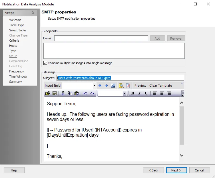

Step 2 – In the Analysis Selection view, select the 5. Help Desk Notification Analysis Task and click on Analysis Configuration. The Notification Data Analysis Module opens.

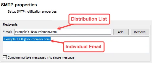

Step 3 – Use the Next button to navigate to the SMTP properties page. Do not make changes to the preceding pages. The email configuration takes place on the SMTP page. Provide the recipients’ email addresses, Message Subject, and add the notification email content.
In the Recipients section, provide the email addresses in the text box or distribution lists in the E-mail field (fully qualified address) for those who are to receive this notification, for example the organization’s Help Desk. Multiple addresses can be input by adding a semicolon (;) and space between entries.
Use the Add and Remove buttons to add or remove the address in the E-mail field from the Recipients list. There is an option to Combine multiple messages into single message, which is checked by default so that it sends one email for all users in the record set instead of one email per user.
In the Message section, the Subject should be configured. Then set the email content in the text box as desired.
Step 4 – To save these configuration changes, use the Next button to navigate to the Summary page. Do not make changes to any other pages. Click Finish. The Notification Data Analysis Module window closes.

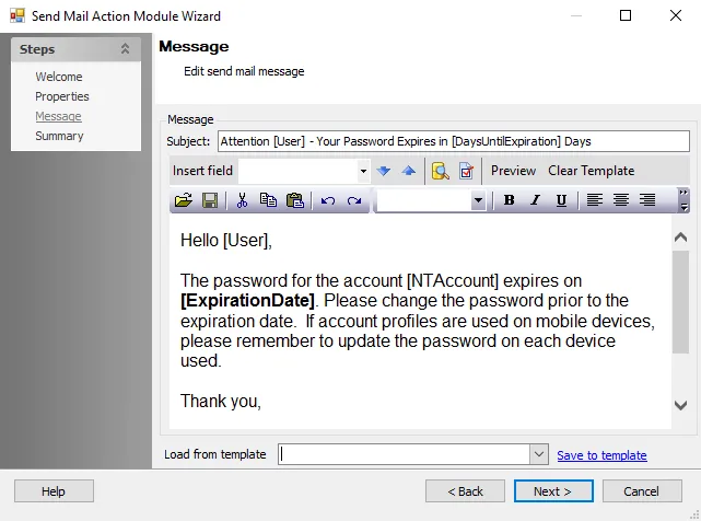

The 1. User Notification Action Task uses the SendMail Action Module to send users notification of password expiration. It targets the SMTP Address Column of the users whose passwords are going to expire within the desired number of days, that is the users listed in the PasswordExpirationNotification_ExpiresWithin15Days_UserNotifications table. The action is enabled by default. Therefore, when the job is executed the following message is sent to all users in the associated table:
Subject: Attention [User] - Your Password Expires in [DaysUntilExpiration] Days
Hello [User],
The password for the account [NTAccount] expires on [ExpirationDate]. Please change the password prior to the expiration date. If account profiles are used on mobile devices, please remember to update the password on each device used.
Thank you,
Netwrix
CAUTION: Do not change the recipient for the action task. While the tags can be moved, do not remove or modify the tags, which are highlighted in bold text above.
The subject or message body can be modified, for example to replace Netwrix
with the
organization’s name. Follow the steps to modify the Subject or message body within the 1. User
Notification Action Task.

Step 3 – In the Action Properties view, the action properties and a preview of the users from the associated table are displayed. Click Configure Action. The Send Mail Action Module Wizard opens.
Step 4 – Click Next to navigate to the Message page. Modify the message Subject and email content as desired.
Step 5 – Click Next and then Finish to save the changes. The Send Mail Action Module Wizard closes.
