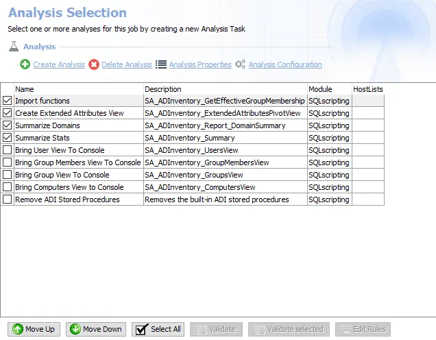

Analysis Selection page
The Analysis Selection view lists all analysis tasks for the selected job. The listed information includes:
  • Name – Name of the analysis task (as provided by the creator of the task)
  • Description – Description of the analysis task (as provided by the creator of the task)
  • Module – Name of the Access Analyzer analysis module
  • HostLists – Indicates the analysis task is applicable to hosts found in the referenced host lists, applies to analysis modules that use host list filters, for example Business Rules analysis module
Option at the top of the Analysis Section
The Analysis section at the top has four options:
  • Create Analysis – Opens the Analysis Properties window for creating and configuring analysis tasks
  • Delete Analysis – Deletes the selected analysis task from the list
    • This action does require confirmation
  • Analysis Properties – Opens the Analysis Properties window for the selected analysis task
  • Analysis Configuration – Opens the selected analysis task’s configuration window
Buttons at the bottom of the Analysis Selection page
At the bottom of the Analysis Selection view, there are action buttons that apply to the table:
  • Move Up – Moves the selected analysis task up the list, which is important since analysis tasks are executed in the order listed in the table
  • Move Down – Moves the selected analysis task down the list, which is important since analysis tasks are executed in the order listed in the table
  • Select All – Selects all analysis tasks in the table for execution
  • Validate – Validates all analysis tasks where the Business Rules analysis module was used
  • Validate selected – Validates selected analysis tasks where the Business Rules analysis module was used
  • Edit Rules – Edits the rule for selected analysis task where the Business Rules analysis module was used
