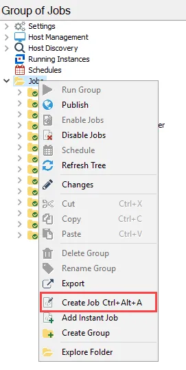

Create Job from Jobs Tree context menu
Step 1 – Select the Jobs tree or the desired job group to add the new job to. Right-click and select Create Job.
New Job added to Jobs Tree
