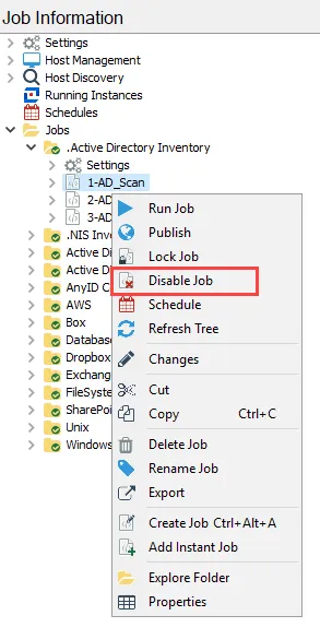

Disable a Job
Jobs can be disabled from the Jobs tree. Disabled jobs cannot be run manually, through a scheduled task, or executed as part of the job group. Follow the steps to disable a job.
Step 1 – Select a job group or job.
NOTE: When disabling jobs at the job group level, all jobs contained in the job group are disabled, but the job group is not disabled. Any additional jobs added to that job group at a later time will be enabled by default.
Disable Job from Jobs Tree
Step 2 – Right-click on the job group or job and select Disable Job(s) from the menu.

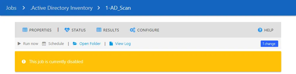

Disabled Job Description page banner
A yellow banner also notifies users that a job is disabled in the Job’s Description page.
Additionally, if a disabled job is run, a warning message appears in the Messages table stating: [UserName] requested [JobName] to run but it is in a disabled state. Job statistics also do not display on the job’s description page.

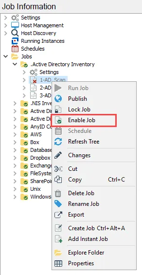

Enable a Job
Jobs that have been disabled can be enabled from the Jobs tree. Following the steps to enable a disabled job.
Step 1 – Select the disabled job. If multiple jobs in a job group are disabled, select the job group to enable all of the disabled jobs.
Enable Job from Jobs Tree
Step 2 – Right-click on the job group or job and select Enable Job(s) from the menu.
The job is now enabled. If a job group was selected, all the jobs in the group are now enabled.
