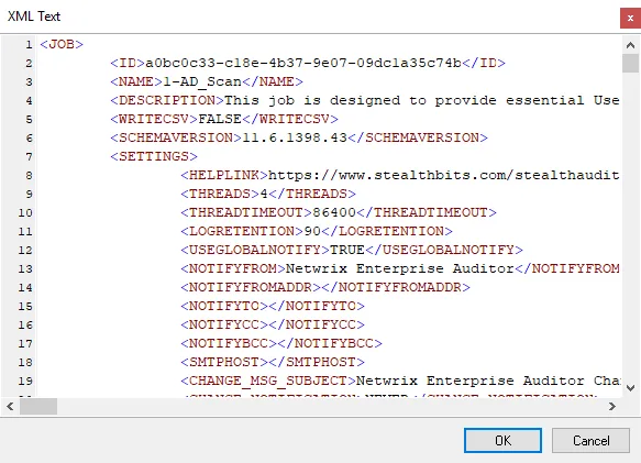

View Job XML File
At the bottom of the Job Properties window is the View XML button. To view the XML file, click View XML.
| View XML button on Job Properties window | | -------------------------------------------------------------------------------------------------------------------- | ------------ | | Job Properties Window | Job XML File |
This opens the job’s XML file, which contains all of the job, query, and reporting configurations. When the log level is directly set at job level, the job XML <JOBLOGLEVEL> parameter will show a value of:
