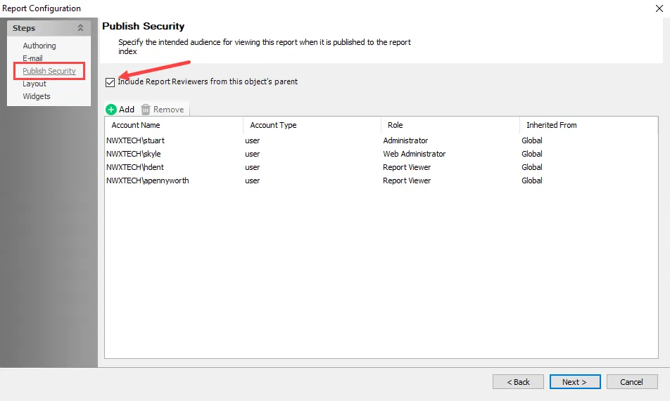

Report Viewer Inheritance
When Role-Based Access is enabled, users assigned the following roles inherit rights to view all reports and their content:
- Administrator role
- Power User role
- Job Builder role
- Job Approver role
- Job Initiator role
- Job Initiator (No Actions) role
- Job Viewer
- Web Administrator
Additional users can be assigned the Report Viewer role at the global, job group, job, or report configuration levels. These rights are inherited down through child objects. However, the Report Viewer role inheritance can be broken at any level. Break inheritance to remove the right to view specific reports at:
- Job Group level – [Job Group] >Settings > Reporting node
- Job level – [Job] > Properties >Report Roles tab
- Report Configuration level – [Job] > Configure > Reports node. Click Configure next to the report, and navigate to the Publish Security page of the Report Configuration wizard. See the Publish Security Page topic for additional information.
| Job Group Level | Job Level | Report Configuration Level |
There are two options that control inheritance for Report Viewers when selected:
- Include Report Viewers from this object’s parent – Automatically removes any user with the Report Viewer role inherited from a parent object at the lower levels
- Set all the child objects to inherit these settings – Only available at the Job Group level. Sets all Jobs and Reports to inherit group settings for all child objects by automatically selecting the Include Report Viewers from this object’s parent option. Any previous configurations are overwritten once Yes is selected in the confirmation window.
