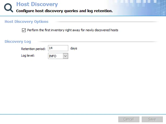

The Host Discovery node is for configuring the settings which dictate how Access Analyzer handles newly discovered hosts, what information is logged during the host discovery process, and how long the logged information is stored.
Host Discovery page
In the Host Discovery Options section at the top is a checkbox for the Perform the first inventory right away for newly discovered hosts option. This option is selected by default.
  • If selected, Access Analyzer retrieves information about a host as soon as it is discovered
  • If deselected, the host inventory information can be obtained later according to the Host Inventory node options
The configurable options in the Discovery Log section are:
  • Retention period – Determines how long the Host Discovery query log is kept. This is set by default to 14 days which is based on average Access Analyzer usage.
  • Log level – Determines what information is stored in the Host Discover query log

    RECOMMENDED: Set the Log Level to Error. The default setting is Info, but it is recommended that the setting for daily use be set to Error. The other log levels are designed to assist with troubleshooting host discovery and host inventory issues.
The Cancel and Save buttons are in the lower-right corner of the Host Discovery view. These buttons become enabled when modifications are made to the Host Discovery global settings. Whenever changes are made at the global level, click Save and then OK to confirm the changes. Otherwise, click Cancel if no changes were intended.
