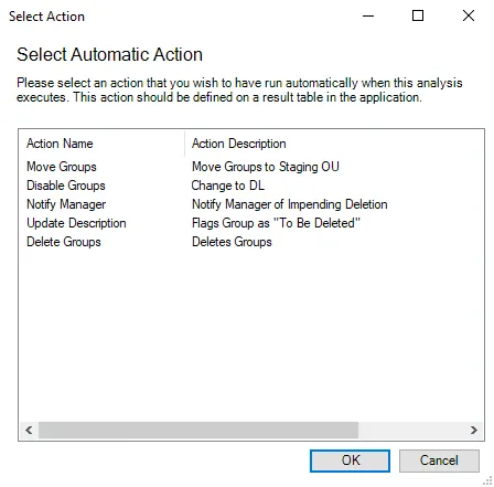

Select Action Window
The Select Action window lists the actions that currently exist within the Job that can be selected to automatically run upon job execution.
Select an action from the list. Click OK to exit the window, and then click Save to preserve the changes made to the analysis module. The action now executes as part of the analysis task. If no actions were selected, it is best practice to click Cancel to close the Select Action window to ensure no accidental selections are saved. Actions only display if they exist within the Actions node of the current Job.
