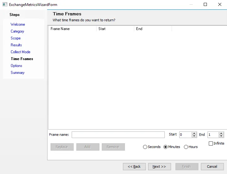

The Time Frames page is used to configure message delivery time frames for which to return summary metrics by server. It is a wizard page for the category of:
  • Delivery Time Custom.
Exchange Metrics Data Collector Wizard Time Frames page
Configure the desired time frames using the following options:
  • Frame name – Name the configured time frame. Can either be entered manually or a default will populate when frame limits are set.
  • Start – Specify the lower limit of the delivery time frame
  • End – Specify the upper limit of the delivery time frame
  • Select the time unit of the time frame:
    • Seconds
    • Minutes
    • Hours
For example, a Start value of 1 and an End value of 2 with the Minutes unit selected returns messages delivered in 1 to 2 minutes.
  • Infinite – Select the checkbox to eliminate the End value from the scan. For example, a Start value of 2 with the Infinite checkbox selected retrieves all messages that took 2 seconds/minutes/hours or longer to deliver.
Once the frame is configured, click Add. The configured message time frame will appear in the list. Multiple time frames can be configured. Select a frame and click Replace to modify an existing frame. Use Remove to delete an existing frame.
