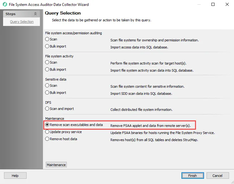

Follow these steps to build a new query using the FSAA Data Collector with the Remove scan executables and data category.
Step 1 – Navigate to the Configure node of a new or chosen job and select the Queries node.
Step 2 – In the Query Selection view, click the Create Query link. The Query Properties window displays.
Step 3 – Select the Data Source tab. From the Data Collector drop-down menu, select FILESYSTEMACCESS and then click the Configure button. The File System Access Auditor Data Collector Wizard opens.
FSAA Data Collector Wizard Query Selection page with Remove scan executables and data option selected
Step 4 – On the Query Selection page, select the Remove scan executables and data category.
Step 5 – Click Finish to save the selection and close the wizard. Then click OK to close the Query Properties window.
This job has now been configured to run the FSAA Data Collector to remove the file system access audit scan applet and data from the target server. Run the job to clean-up the targeted hosts.

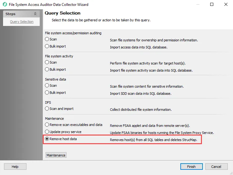

Follow the steps to build a new query using the FSAA Data Collector with the Remove host data category.
Step 3 – Select the Data Source tab. From the Data Collector drop-down menu, select FILESYSTEMACCESS and then click Configure. The File System Access Auditor Data Collector Wizard opens.
FSAA Data Collector Wizard Query Selection page with Remove host data option selected
Step 4 – On the Query Selection page, select the Remove host data category.
This job has now been configured to run the FSAA Data Collector to remove the host identified in the job’s Configure > Hosts node. Run the job to clean-up the targeted hosts.

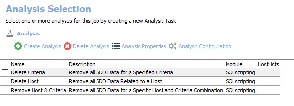

The analysis tasks are deselected by default. View the analysis tasks by navigating to the Jobs > FS_SDD_DELETE > Configure node and select Analysis.
CAUTION: Applying these analysis tasks result in the deletion of collected data.
FS_SDD_DELETE Job Analysis Selection page
  • Delete Criteria – Remove all SDD Data for a Specified Criteria
  • Delete Host – Remove all SDD Data Related to a Host
  • Remove Host & Criteria – Remove all SDD Data for a Specific Host and Criteria Combination
Configure the FS_SDD_DELETE Analysis Tasks
Follow the steps to configure and run the analysis tasks.
Step 1 – Prior to job execution, modify the desired analysis tasks using the Customizable Analysis Parameters for FS_SDD_DELETE Job instructions.
Step 2 – In the Analysis Selection Pane, check the type of analysis task that will be run.
Step 3 – Right-click the FS_SDD_DELETE Job and select Run Job. The analysis execution status is visible from the Running Instances node.
Step 4 – When the job has completed, return to the Analysis Selection Pane and deselect all analysis tasks.
CAUTION: Do not leave these analysis tasks checked in order to avoid accidental data loss.

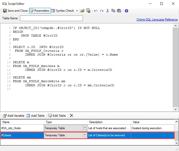

The parameters that can be customized are listed in a section at the bottom of the SQL Script Editor. Follow the steps to customize analysis task parameters.
Step 1 – Navigate to the FS_SDD_DELETE > Configure node and select Analysis.
Step 2 – In the Analysis Selection view, select the desired analysis task and click on Analysis Configuration. The SQL Script Editor opens.
 FS_SDD_DELETE Job Analysis Task in SQL Script Editor
Step 3 – In the Parameters section at the bottom of the editor, select either the #Criteria or #hosts row, depending on the analysis task chosen, and then Edit Table. The Edit Table window opens.
CAUTION: Do not change any parameters where the Value states Created during execution.
SQL Script Editor Edit Table window
Step 4 – Use the Add New Item button to enter host names or criteria to the temporary table list manually, or select the Browse button to upload a list of hosts in CSV format. Click OK to save any changes. Other Edit Table buttons include:
  • Edit a Value
  • Delete this row/column
  • Move up
  • Move down
Step 5 – Click Save and Close to finalize the customization and close the SQL Script Editor.
The job is now ready to be executed.

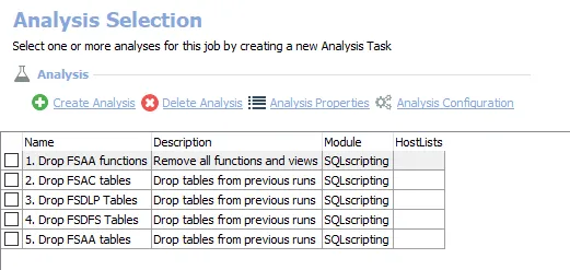

The analysis tasks are deselected by default. View the analysis tasks by navigating to the Jobs > FS_DropTables > Configure node and select Analysis.
FS_DropTables Job Analysis Selection page
    1. Drop FSAA functions – Removes all functions and views from previous runs of the File System Solution
    1. Drop FSAC tables – Drops the File System Activity Auditing tables imported from the previous runs
    1. Drop FSDLP Tables – Drops the File System Sensitive Data Discovery Auditing tables imported from the previous runs
    1. Drop FSDFS Tables – Drops the File System DFS Auditing tables imported from the previous runs
    1. Drop FSAA Tables – Drops File System Access Auditing tables imported from the previous runs
Do not try to run these tasks separately, as they are designed to work together. Follow these steps to run the analysis tasks:
Step 1 – In the Analysis Selection Pane, click Select All. All tasks will be checked.
Step 2 – Right-click the FS_DropTables Job and select Run Job. The analysis execution status is visible from the Running Job node.
Step 3 – When the job has completed, return to the Analysis Selection Pane and click Select All to deselect these analysis tasks.
