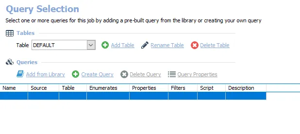

Query Selection
The Access Analyzer data collectors can collect information from a wide range of environments. Data collection tasks are assigned to jobs at the Configure > Queries node level. See the Queries Node topic for additional information.
The Query Selection page is split into the Tables and Queries sections. The Tables section has the following options:
- Table – Select a pre-configured table or select DEFAULT to create a new one
- Add Table – Add a new table to the Table dropdown list
- Rename Table – Rename the current table selected
- Delete Table – Delete the current table selected
The Queries section is where the Data Collectors are configured. The Queries section has the following options:
- Add from Library – Opens the Libraries window. Add a pre-built query from the Access Analyzer library. See the Add Query from Library topic for additional information.
- Create Query – Click Create Query to add a new query task to a job. See the Create or Modify a Query topic for additional information.
- Delete Query – Delete the currently selected query
- Query Properties – Select an existing query and click Query Properties to modify its configuration

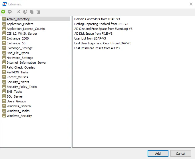

Pre-built queries can be added to the Data Collector job through the Libraries window.
The Libraries window toolbar has the following options:
- Create New Library – Create a new library entry. The new Library will be added to the Library dropdown menu.
- Delete Library – Deletes the currently selected library
- Cut – Cut the selected task in the library to the clipboard
- Copy – Copy the selected task in the library to the clipboard
- Paste – Paste cut or copied item from the clipboard into the currently selected library
- Delete Selected Task – Deletes the currently selected task
Click Add to confirm the query selection and add it to the Queries list on the Query Selection page. If no selection is needed or intended, click Cancel to close the Libraries window without adding a pre-built query into the Queries list.

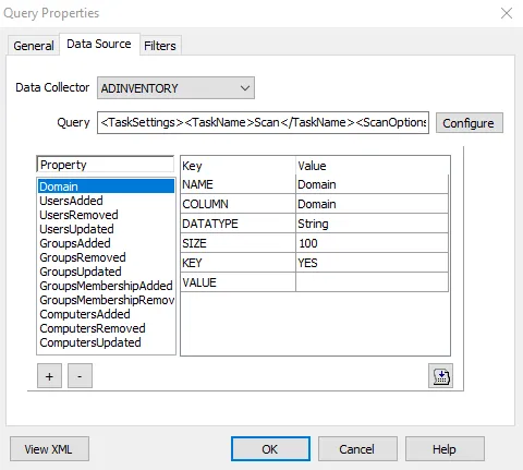

Data Source Tab
Use the Data Source tab to configure the data collector and query.
| New Query | Existing Query |
The Data Source tab displays:
- Data Collector – Data collector selected from the drop-down menu.
- Query – Query configuration string.
- Configure – Opens the wizard for the selected data collector. Each Data Collector task has its own Configuration Wizard.
- Properties – Configured query properties.
When creating a new query, expand the Data Collector drop-down menu, which provides a list of all licensed data collectors in alphabetical order. The Query and Property sections are auto-filled according to the configuration. The buttons at the bottom of the Property section are for advanced features to manipulate the query. The + and – buttons manually add or remove individual properties from the query. The script button opens the VBScript Editor window for query manipulation scripts.
RECOMMENDED: Use the Data Collector Configuration wizards for basic query modifications. For more complex modifications, contact Netwrix Support.
See the individual data collector section for configuration wizard page information.
