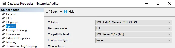

Step 1 – Access the Database Properties in SQL Server Management Studio.
SQL Server Management Studio Database Properties window
Step 2 – Select Options and set the collation.
Now that the collations match, proceed with Access Analyzer installation.

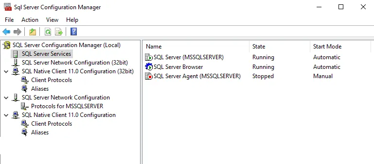

SQL Server Configuration Manager
Step 1 – Stop the SQL Server service from the Configuration Manager.
