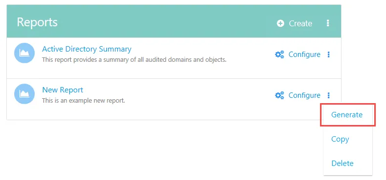

Step 4 – Click the vertical ellipsis menu next to the report and select Generate.
The report is now created. To access the new report, see the Viewing Generated Reports topic.
