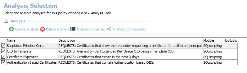

Analysis Tasks for the AD_CertificateRequests Job
Navigate to the Active Directory > 7.Certificate Authority > AD_CertificateRequests > Configure node and select Analysis to view the analysis tasks.
  • Suspicious Principal Certs – Identifies certificates that show the requester requesting a certificate for a different principal
  • OID in Template – Analysis on certificate Extended Key Usage (EKU) Object Identifier (OID) being in template OID
  • Certificate Expiration – Identifies certificates that expire in the next number of days set by the customizable parameter. The default number of days is 60. Creates the SA_AD_CertificateRequests_ExpiringSoon table accessible under the job’s Results node.
  • Authentication Based Certificates – Identifies certificates that contain Authentication based OIDs. Creates the SA_AD_CertificateRequests_AuthenticationBasedCertiifcates view accessible under the job’s Results node.
