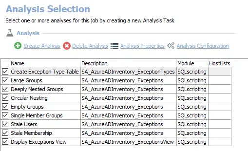

Analysis Tasks for the 2-AAD_Exceptions Job
Navigate to the .Entra ID Inventory > 2-AAD_Exceptions > Configure node and select Analysis. Analysis tasks with configuration parameters that define security concerns can be modified.
CAUTION: Most of these analysis tasks are preconfigured and should not be modified and not be deselected. There are a few which are deselected by default, as they are for troubleshooting purposes.
- Create Exception Type Table – Creates a processing table in the database for use by downstream analysis and report generation
- Large Groups
- Identifies groups that exceed the defined threshold for effective group membership
- Populates processing tables in the database for use by downstream analysis and report generation
- This analysis task has configurable parameters
- Definition of a larger group can be customized
- Deeply Nested Groups
- Identifies groups that exceed the defined threshold of deep levels of membership nesting
- Definition of a deeply nested group can be customized
- Circular Nesting
- Identifies groups with circular references in their effective membership
- Empty Groups
- Identifies groups with no membership
- Single Member Groups
- Identifies groups with a single direct member
- Stale Users
- Identifies user accounts that are disabled or exceed the defined threshold of inactivity
- Definition of a stale user can be customized
- Stale Membership
- Identifies groups with a high percentage of effective members that are stale users
- Definition of a stale membership can be customized
- Display Exceptions View – Creates the SA_AzureADInventory_ExceptionsView accessible under the job’s Results node

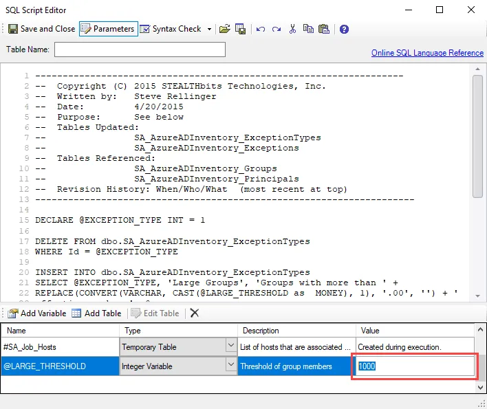

Customizable parameters enable Access Analyzer users to set the values used to classify user and group objects during this job’s analysis. The parameters can be customized and are listed in a section at the bottom of the SQL Script Editor. Follow the steps to customize an analysis task’s parameters.
CAUTION: Modifying these parameters affects solutions with .Entra ID Inventory Job Group dependency.

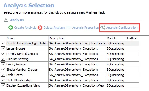

Step 1 – Navigate to the .Entra ID Inventory > 2-AAD_Exceptions > Configure node and select Analysis.
Step 2 – In the Analysis Selection view, select an analysis task and click Analysis Configuration. The SQL Script Editor opens.
Step 3 – Click Parameters to open the Parameters section.
Step 4 – Double-click in a field in the Value column and enter a custom value.
CAUTION: Do not change any parameters where the Value states Created during execution.
Step 5 – Click Save and Close to finalize the customization and close the SQL Script Editor.
