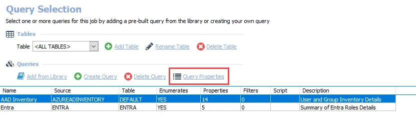

Step 1 – Navigate to the .Entra ID Inventory > 1-AAD_Scan > Configure node and select Queries.
Step 2 – In the Query Selection view, click on Query Properties to open the Query Properties window.

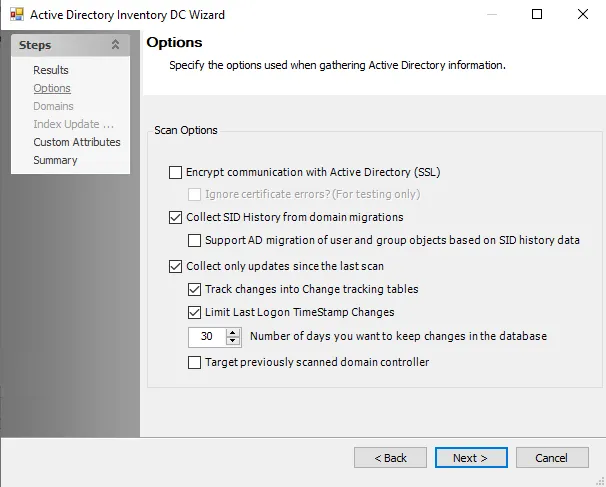

Step 4 – On the Options page, select the different Scan Options as needed:
Collect only updates since the last scan – Enables differential scanning.
NOTE: Enabling the Collect Open Extensions option on the Custom Attributes page overrides this function.
Collect sign-in activity with scan – Required to collect the LastLogonTimestamp attribute of user objects. A message will alert users that deselecting this option will disable this function.
Collect Directory Audit Events – Collect Microsoft Entra ID audit logs

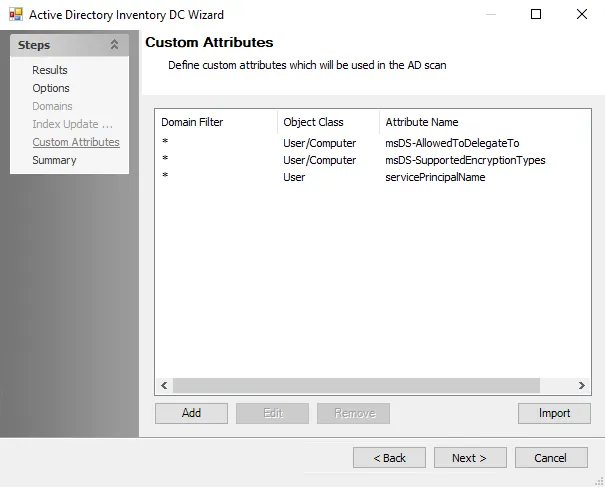

Step 5 – On the Custom Attributes page, click Add or Import to add or import custom attributes.
Select Collect Open Extensions to enable the data collector to collect all extension attributes in Microsoft Entra ID. Enabling this option will increase scan times.
NOTE: Enabling this option overrides the differential scan setting and will direct the data controller to run a full scan every time the job is run.
See the AzureADInventory Data Collector topic for additional information on adding and importing custom attributes.

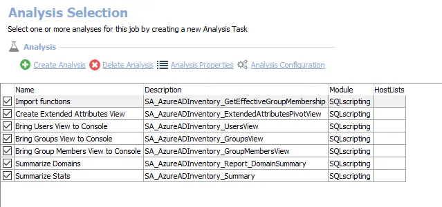

Navigate to the .Entra ID Inventory > 1-AAD_Scan > Configure node and select Analysis to view the analysis tasks.
- Import functions – Imports effective group membership function into the database
- Create Extended Attributes View – Enables the SA_AzureADInventory_ExtendedAttributesPivotView to be accessible under the job’s Results node
- Bring Users View to Console – Enables the SA_AzureADInventory_UsersView to be accessible under the job’s Results node
- Bring Groups View to Console – Enables the SA_AzureADInventory_GroupsView to be accessible under the job’s Results node
- Bring Group Members View to Console – Enables the SA_AzureADInventory_GroupMemberssView to be accessible under the job’s Results node
- Summarize Domains – Creates interim processing tables in the database for use by downstream analysis and report generation
- Summarize Stats – Creates interim processing tables in the database for use by downstream analysis and report generation
