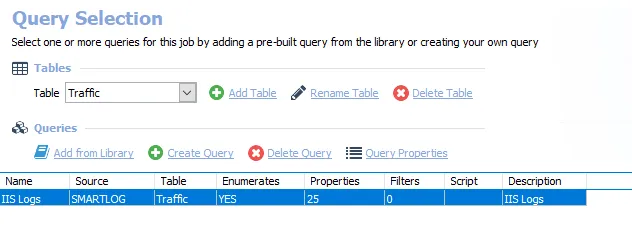

Step 1 – Navigate to the Exchange > 2. CAS Metrics > 0. Collection > EX_IISLogs > Configure node and select Queries.
Step 2 – In the Query Selection view, click Query Properties. The Query Properties window opens.

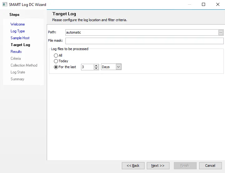

Step 3 – Select the Data Source tab, and click Configure. The SMART Log DC Wizard opens.
CAUTION: Do not modify other wizard pages. The other wizard pages are pre-configured for this job.
SMART Log DC Wizard Target Log page
Step 4 – Navigate to the Target Log page, and configure the time frame as required. See the SMARTLog: Target Log topic for additional information.
Remember, if the date range configuration includes data older than the last scan, the Persist Log State checkbox on the Log State page must be disabled.
Step 5 – Navigate to the Summary page. Click Finish.
