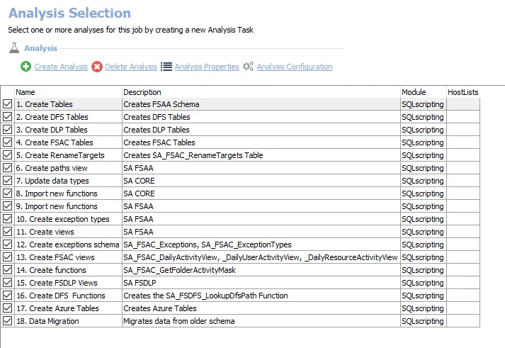

Analysis Tasks for the 0-Create Schema Job
View the analysis task by navigating to the FileSystem > 0.Collection > 0-Create Schema > Configure node and select Analysis.
Analysis Selection for the 0-Create Schema Job
    1. Create Tables – Creates all tables prefaced with SAFSAA
    1. Create DFS Tables – Creates all tables prefaced with SAFSDFS
    1. Create DLP Tables – Creates all tables prefaced with SAFSDLP
    1. Create FSAC Tables – Creates all tables prefaced with SAFSAC
    1. Create Rename Targets – Creates the SA_FSAC_Rename Targets tables
    1. Create Paths View – Creates the SA_FSAA_Paths view
    1. Update data types – Access Analyzer uses custom SQL data types to render data. This analysis creates updates to those data types.
    1. Import new functions – Creates functions used in the File System Solution that only reference the .Active Directory Inventory job group data
    1. Import new functions – Creates the FSAA functions used in the File System Solution that reference the 0.Collection job group data
    1. Create exception types – Creates the SA_FSAA_ExceptionTypes table
    1. Create views – Creates the SA_FSAA_DirectPermissionsView
    1. Create Exceptions Schema – Creates the SA_FSAC_Exception table and the SA_FSAC_ExceptionTypes table
    1. Create FSAC Views – Creates all views prefaced with SAFSAC
    1. Create Functions – Creates the FSAC functions used in the File System Solution that reference the 0.Collection job group data
    1. Create FSDLP Views – Creates all views prefaced with SAFSDLP
    1. Create DFS Functions – Creates the FSDFS functions used in the File System Solution that reference the 0.Collection job group data
    1. Create Azure Tables – Creates tables for Azure Files
    1. Data Migration – Migrates data from an older schema version
