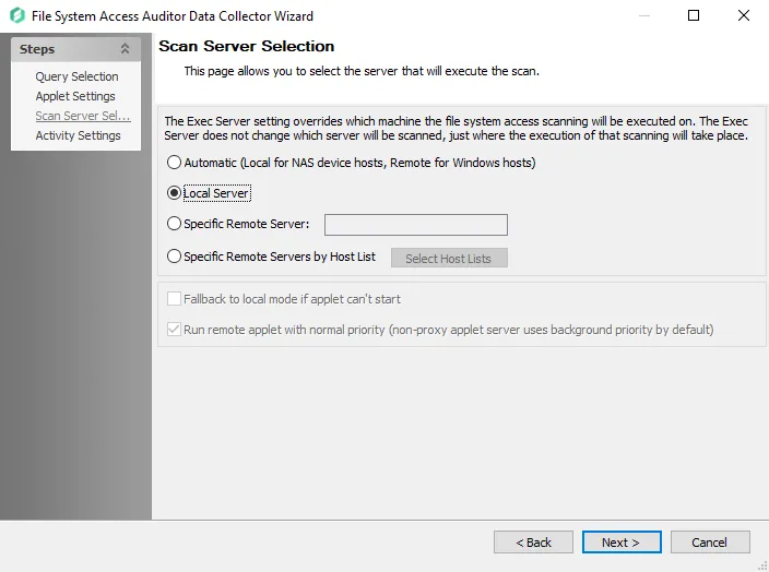

Scan Server Selection page:
- Set to Local Server, or local mode scans

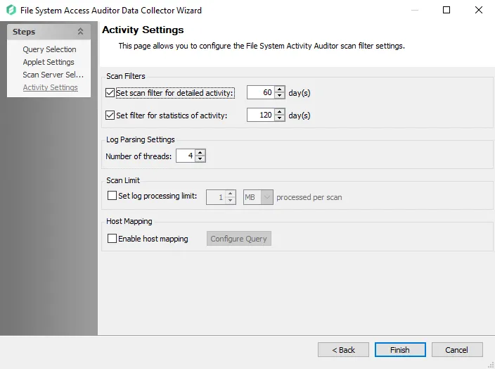

Activity Settings page:
- Set scan filter for detailed activity 60 days
- Set filter for statistics of activity 120 days

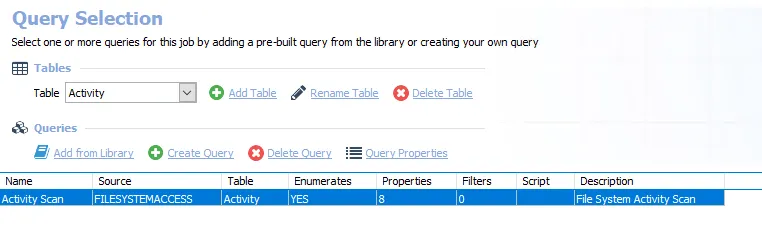

Step 1 – Navigate to the FileSystem > 0.Collection > 1-FSAC System Scans > Configure node and select the Queries node.
Step 2 – In the Query Selection view, click Query Properties. The Query Properties window opens.

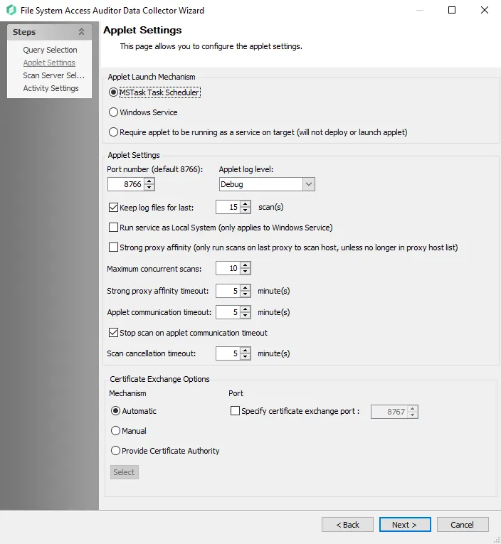

Step 4 – The Applet Settings page applies to the applet and proxy mode scans which are selected on the Scan Server Level Page. If employing proxy servers, see the FSAA: Applet Settings topic for configuration instructions.
Step 5 – The Scan Server Selection page applies to the applet and proxy mode scans. Remember, each mode has different provisioning requirements. See the FSAA: Scan Server Selection topic for additional information.
Step 6 – On the Activity Settings page:
- Modify the number of days detailed activity is kept
- Modify the number of days activity statistics are kept
- Modify log parsing limits
See the FSAA: Activity Settings topic for additional information.
