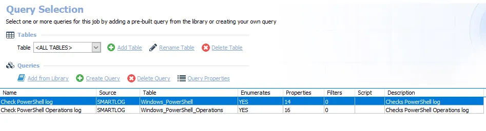

Step 1 – Navigate to the Jobs > Windows > Security Utilities > SG_PowerShellCommands > Configure node and select Queries. Select the Check PowerShell log query.
Step 2 – In the Query Selection view, click Query Properties. The Query Properties window opens.

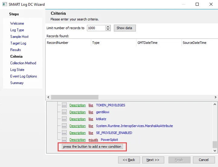

Step 3 – Select the Data Source tab, and click Configure. The Smart Log Data Collector Wizard opens.
Step 4 – If the Criteria tab is grayed out, click Next through the windows until the tab is accessible.
Smart Log Data Collector Wizard Criteria page
Step 5 – On the Criteria page, click the press the button to add a new condition box.
Step 6 – Enter the desired conditions.
Step 7 – Click Next to navigate to the Summary page and click Finish.
The Check PowerShell log query has now been saved with the new conditions.

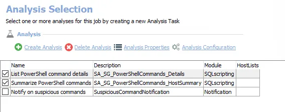

View the analysis tasks by navigating to the Windows > Security Utilities > SG_PowerShellCommands > Configure node and selecting Analysis.
Analysis Tasks for the SG_PowerShellCommands Job
  • List PowerShell command details – Creates an interim processing table in the database for use by downstream analysis and report generation
  • Summarize PowerShell commands – Creates the SA_PowerShellCommands_HostSummary table accessible under the job’s Results node
The optional analysis tasks is:
  • Notify on suspicious commands – Enable this analysis task and the select Analysis Configuration to open the Notification Data Analysis Module Wizard to configure it to send notifications on suspicious commands. See the Configure the Notify on Suspicious Commands Analysis Task topic for additional information.

Step 1 – Navigate to the Jobs > Windows > Security Utilities > SG_PowerShellCommands > Configure node and select Analysis.
Step 2 – In the Analysis Selection view, select the Notify on suspicious commands analysis task and click Analysis Configuration. The Notification Data Analysis Module opens.

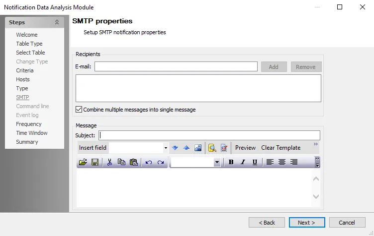

Notification Data Analysis Module wizard SMTP properties page
Step 3 – Use the Next button to navigate to the SMTP page. Do not make changes to the preceding pages.
Recipients section
Step 4 – In the Recipients section, provide the email addresses or distribution lists (fully qualified address) for those who are to receive this notification. Multiple addresses can be provided. You can use the following options:
  • Add – Add an email address to the E-mail field
  • Remove – Remove an email address from the Recipients list
  • Combine multiple messages into single message – Sends one email for all objects in the record set instead of one email per object to all recipients
Message section
Step 5 – In the Message section, edit the Subject. It is not recommended to remove any parameters. Then, customize the email content in the textbox to provide an explanation of the notification to the recipients.
Step 6 – To save these configuration changes, use the Next to navigate to the Summary page. Do not make changes to any other pages. Click Finish. The Notification Data Analysis Module window closes.
Step 7 – This notification analysis task is now configured to send emails. In the Analysis Selection view, select this task so that notifications can be sent automatically during the execution of the SG_PowerShellCommands job.
The Notify on suspicious commands analysis task is now configured to send notifications.
