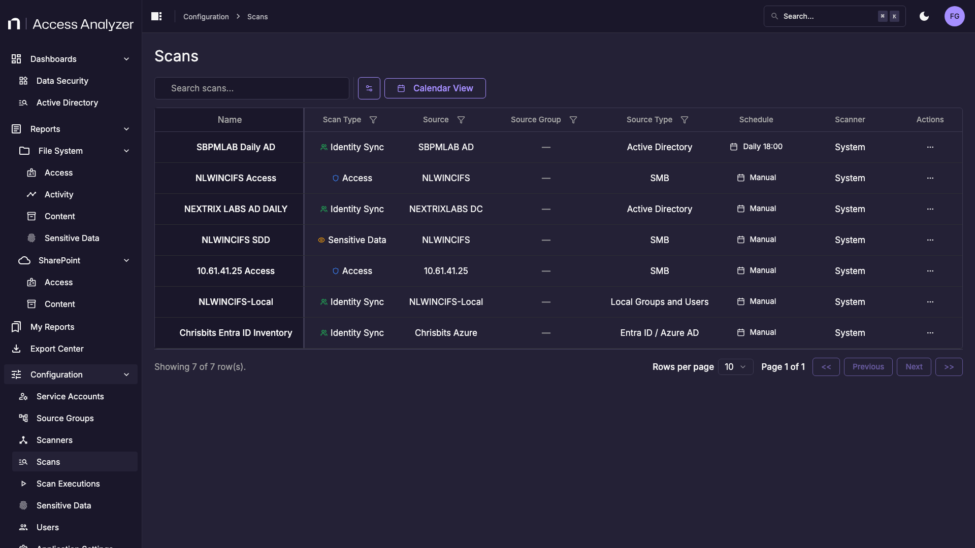

Managing scans
Navigate to Configuration > Scans to view and configure all scans across your sources.
Scans list showing existing scans with columns for Name, Scan Type, Source, Source Group, Source Type, Schedule, Scanner, and Actions
Each row shows a scan's type, source, schedule, and assigned scanner. Click the scan name to open the edit panel for that scan.

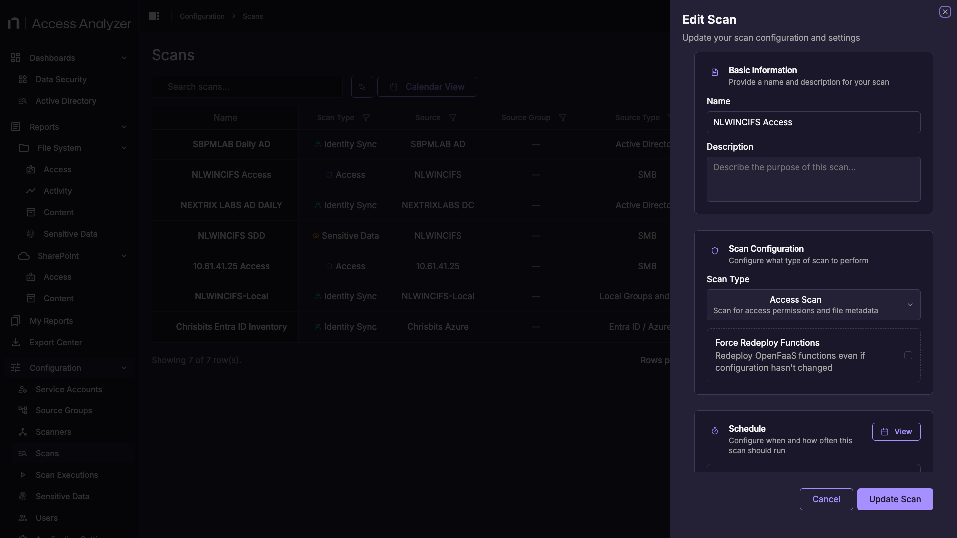

File Server — Access Scan parameters
The Access Scan collects file permissions, share structure, and file metadata from file servers.
Edit Scan panel for a File Server access scan showing Basic Information, Scan Configuration, and Schedule sections
AA26 ParameterDescriptionLegacy Equivalent
NameDisplay name for this scan.Job name
DescriptionOptional notes.Job description
Scan TypeSet to Access Scan.FSAA — Access/Permission Auditing query
ScheduleEnable and configure a recurring schedule.Windows Task Scheduler trigger on the job
The Access Scan has no additional scoping parameters. It scans all accessible shares on the source server. Use the Sensitive Data Scan's Share Selection parameter to scope sensitive data collection to specific shares.

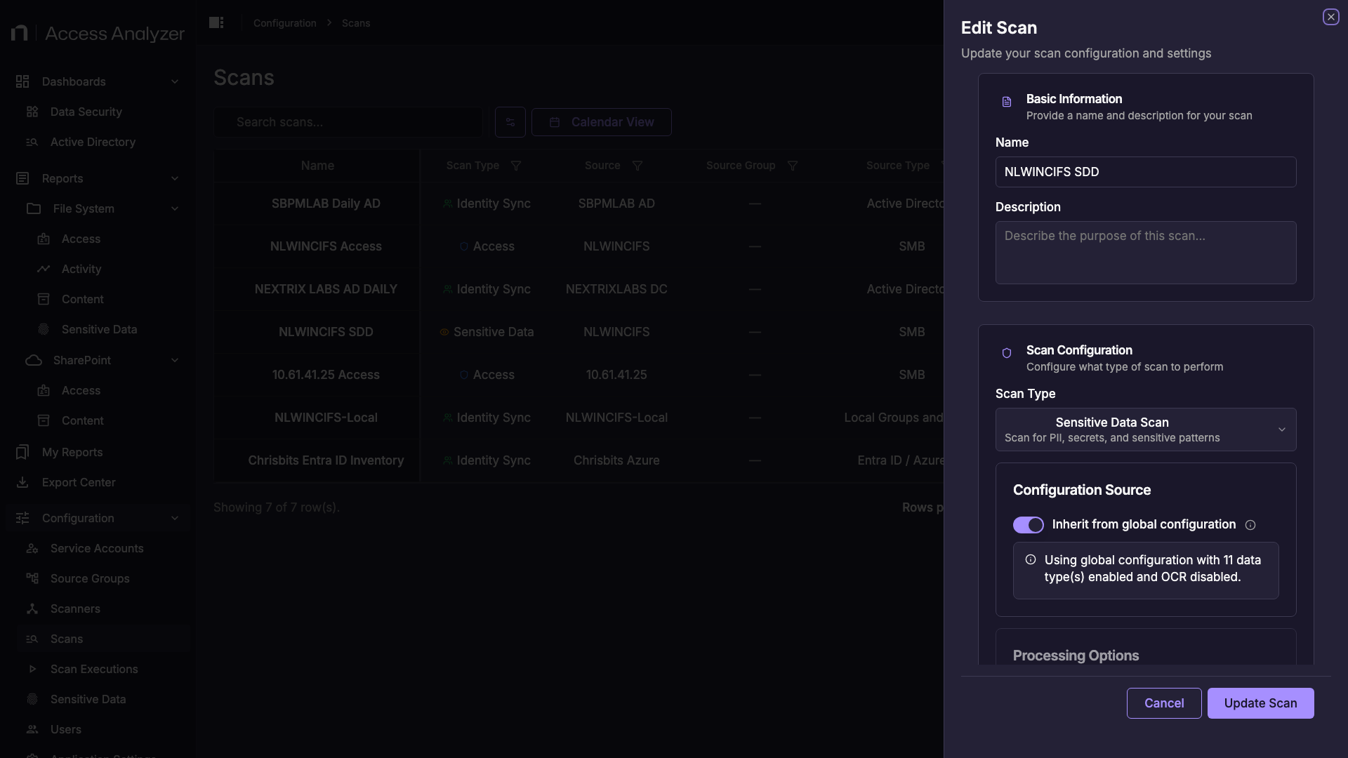

File Server — Sensitive Data Scan parameters
The Sensitive Data Scan classifies file contents against configured data type patterns. It must be run after the Access Scan — the scan uses the share list discovered by the Access Scan to determine scope.
Edit Scan panel for a File Server sensitive data scan showing Scan Type, Configuration Source, and Processing Options sections
Scan TypeSet to Sensitive Data Scan.FSAA — Sensitive Data Discovery query
Configuration SourceInherit from global configuration uses the globally configured sensitive data types. Select a custom configuration to override for this scan.Global sensitive data policy
Run OCREnable to extract text from image files during classification.FSAA OCR option
Sensitive Data Types to ClassifySelect which data type categories to classify against: CCPA, CMMC, Credentials, Financial Records, GDPR, GDPR Restricted, GLBA, HIPAA, PCI DSS, PHI, PII.Sensitive data criteria selection in FSAA wizard
Batch SizeNumber of files to process per batch. Default: 100.No direct equivalent
WorkersNumber of concurrent workers for scanning. Default: 3.FSAA thread count or concurrent scan settings
Differential ScanWhen enabled, only files modified since the last scan are classified. The first run scans all files.FSAA incremental scan option
Share SelectionRestrict the scan to specific shares discovered by the Access Scan. If empty, all discovered shares are scanned.FSAA include/exclude share lists
Maximum Scan DepthFolder depth limit. Leave empty for unlimited depth.FSAA scan depth setting
The Share Selection list is populated from the results of the Access Scan. If no shares appear, run the Access Scan for that source first.

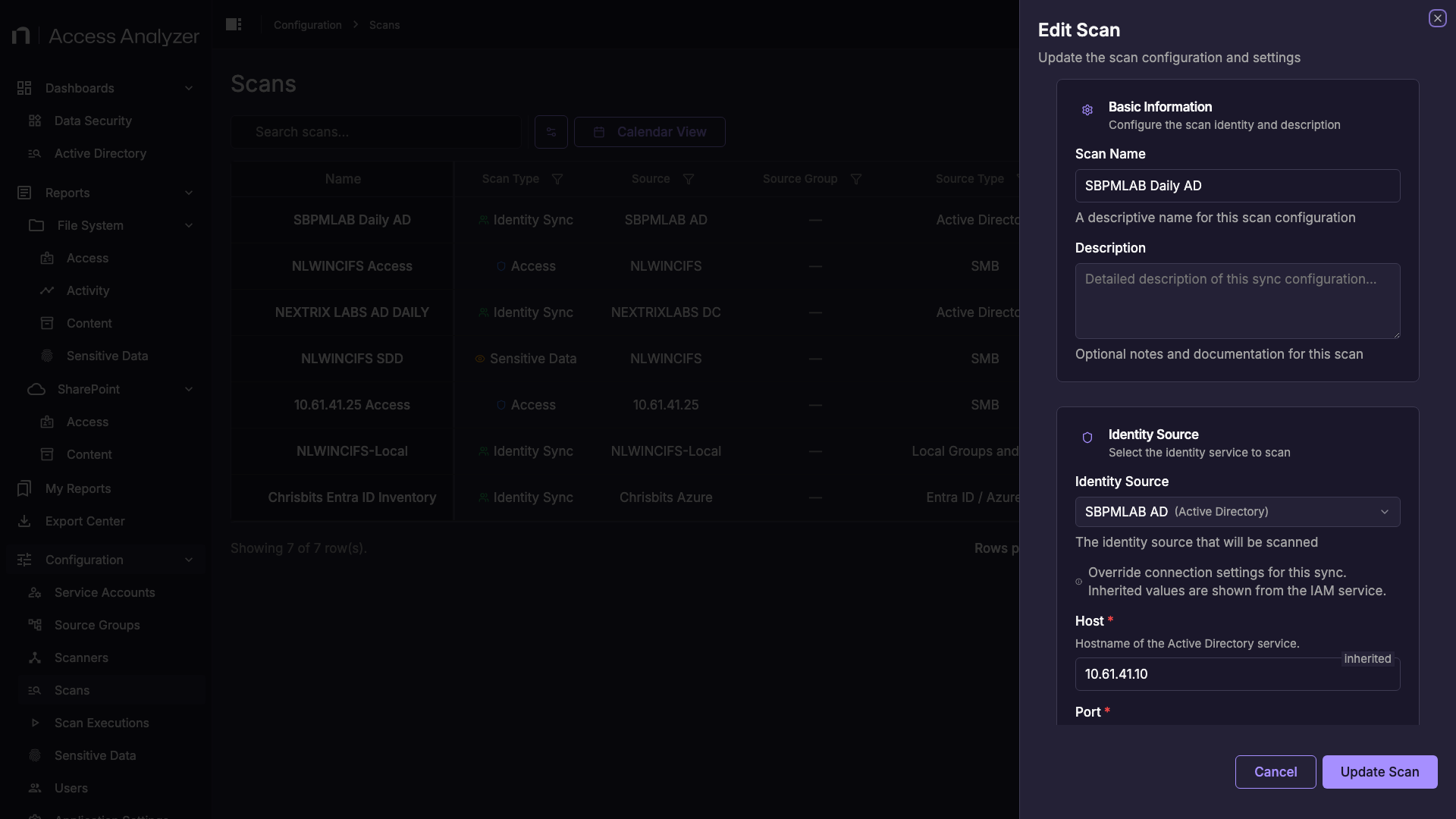

Active Directory — Identity Sync parameters
The Identity Sync collects users, groups, group membership, and custom attributes from Active Directory domain controllers.
Edit Scan panel for an Active Directory identity sync showing Identity Source, connection override settings, and Schedule
Scan NameDisplay name for this sync.Job name
Identity SourceThe Active Directory source to sync. Selects the domain controller configured on the source.Job host target / connection profile
Host / Port / DomainOverride the connection settings inherited from the source. Leave as inherited unless you need to target a specific domain controller.ADInventory domain and DC settings
Ignore SSL ErrorsIgnore certificate errors on the LDAP/LDAPS connection.ADInventory SSL options
Differential ScanWhen enabled, only changes since the last sync are collected.ADInventory incremental collection
ScheduleFrequency: One-time, Hourly, Daily, Weekly, or Monthly. Set a specific time and optional start/end date.Windows Task Scheduler trigger
AA26 collects standard Active Directory attributes: users, groups, group membership, and user custom attributes. Custom attribute collection beyond this set is not configurable in the current release.

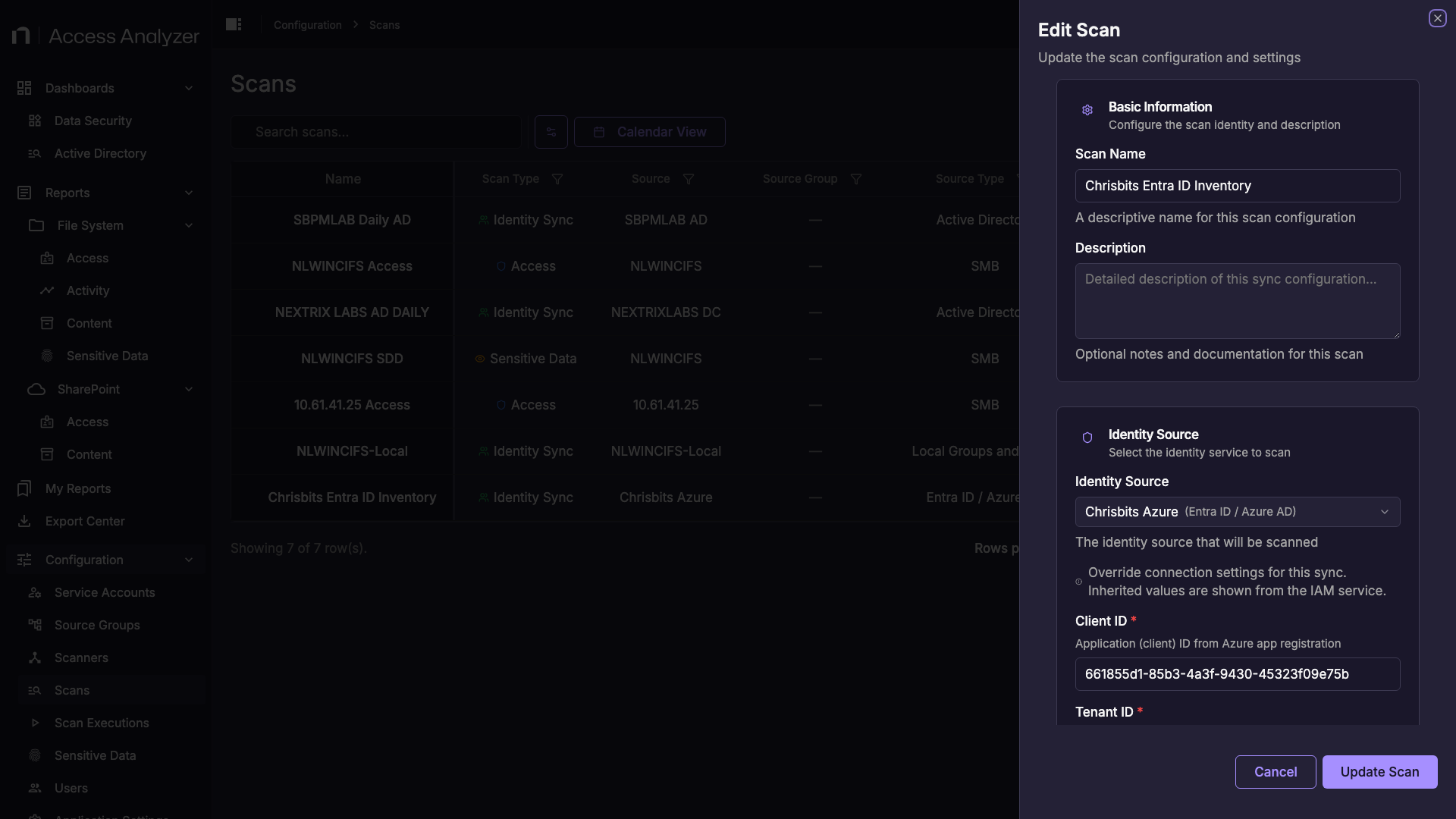

Entra ID — Identity Sync parameters
The Identity Sync collects users, groups, and roles from Entra ID via the Microsoft Graph API.
Edit Scan panel for an Entra ID identity sync showing Identity Source, connection override settings, and Schedule
Identity SourceThe Entra ID source to sync.Job host target
Client ID / Tenant IDOverride the credentials inherited from the source's service account. Leave as inherited in most cases.AzureAD Inventory connection profile
